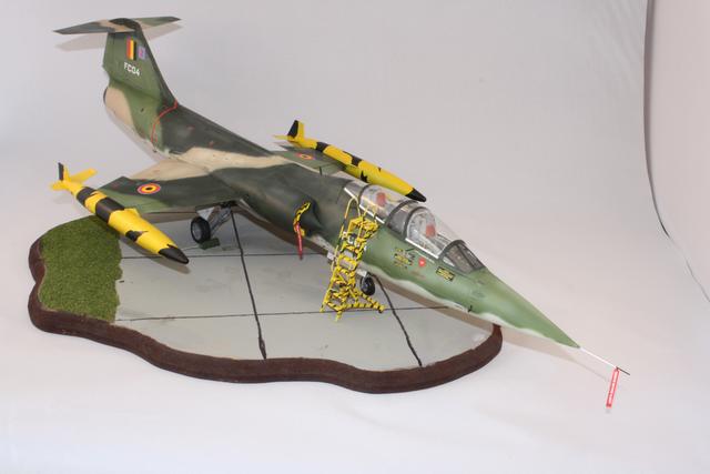

MikeC Posted March 22 Posted March 22 (edited) Always good to see a Starfighter. A couple of points you may wish to be aware of, if you weren't already. I used the Daco decals, including some of the stencils. They're great, but I think they were sized for the Hasegawa kits, so there were one or two slight mismatches, for example with the surface detail. No biggy, but easily adaptable. Secondly, the Belgian "SEA" camo was not exactly the same as that on US aircraft, the FS numbers differed slightly. Iirc the Daco sheet has the appropriate information, if not let me know, I think I still have it somewhere. Without wishing to hijack your thread, here's my take on a Belgian T-bird depicted at the last Tiger Meet the 104 attended just before retirement from Belgian service. Good luck, looking forward to seeing this progress. Edited March 22 by MikeC Biggles87, Kagemusha, Madmax and 2 others 5

Grunticus Posted March 22 Author Posted March 22 1 hour ago, MikeC said: Always good to see a Starfighter. A couple of points you may wish to be aware of, if you weren't already. I used the Daco decals, including some of the stencils. They're great, but I think they were sized for the Hasegawa kits, so there were one or two slight mismatches, for example with the surface detail. No biggy, but easily adaptable. Secondly, the Belgian "SEA" camo was not exactly the same as that on US aircraft, the FS numbers differed slightly. Iirc the Daco sheet has the appropriate information, if not let me know, I think I still have it somewhere. Without wishing to hijack your thread, here's my take on a Belgian T-bird depicted at the last Tiger Meet the 104 attended just before retirement from Belgian service. Good luck, looking forward to seeing this progress. Thanks for bringing it to my attention Mike. Your Starfighter looks gorgeous! If you could dig up that color info it would be highly appreciated. I was already investigating the lighter green color, as in my memory it was a tad greener than the USAF shade. The Daco decals will be used to supplement the kit ones, for those that are not on the kit sheet. The kit decals are superb. In this image the lighter green appears very much USAF-like: A lot 'greener' in these, showing my subject: But wait, there's more! The one in front is either two-tone, or a very different light green compared to the middle one. I'm going to stick with a greener shade compared to USAF SEA, so the middle one. I think it's a later scheme given the deleted intake roundels and smaller fuselage codes. Cheers, Leon MikeC, Daniel Leduc, Kagemusha and 1 other 4
