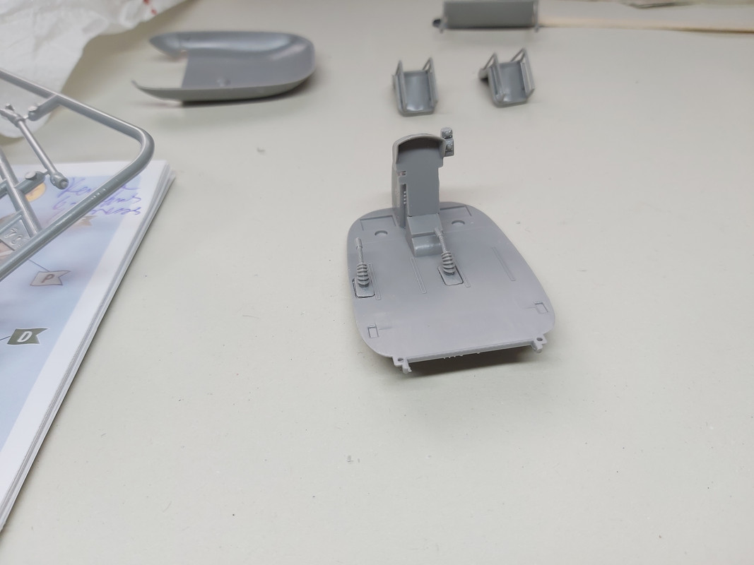

MikeC Posted March 20 Author Posted March 20 Well I've made a start. A read-through of the instructions confirmed my suspicions that a modular approach would suit this kit, and the first module is unsurprisingly the cabin unit. So no change with this kit, we start in the cockpit. The seats have moulded-in seat harnesses, representing said harnesses fastened and tightened. For the three rear seats, I decided the representation was good enough: I could live with this, given that if the aircraft was flown with these seats empty, their harnesses would be fastened - loose harnesses being a flight safety hazard, of course. These seats are fiddly to assemble as they consist of the "bench" (they were actually canvas on a tubular frame if I've interpreted photos correctly) to which is added the two side struts: the locations are not the most positive, but provided it's left to set it works. The front seats were a different matter, as the harnesses were more likely to be undone when on the ground. So the first job was to scrape off the harness ... ... then add the support frames. Can you see the problem here? The back and bottom of the seats are open, but in fact the photos I have show a filled-in back covering the frame. (Alas I can't post said photos here due to copyright, but a quick Google should turn some up for you). I'll have a think about how I do that while the glue sets properly. In the meantime, I ordered up two sets of generic RAF seat belts, then made a start on the rest of the cockpit, adding the collective controls and the instrument panel. Firstly, on reflection, I removed the "add-on" on the right, as it does not seem to appear except in later years. Some sort of nav instrument? Secondly, I decided that I will probably use the panel decal supplied in the kit, but may see if I can scratch something up from the spares box. Thirdly, I reflected that there would be some filler needed in this model. But I also made a start on the skid undercarriage. The kit supplies a pair of wheels, which were sometimes fitted to Army Air Corps (AAC) examples; but not to to my subject. However, the mountings were present on the real thing (presumably the wheels were a relatively easy optional fit if needed). So it was a simple matter of a couple of snips, some filing, and some drilling, to proceed from this ... ...to this. And that's where we are so far. KiwiZac, Landrotten Highlander, Stevepd and 11 others 14
