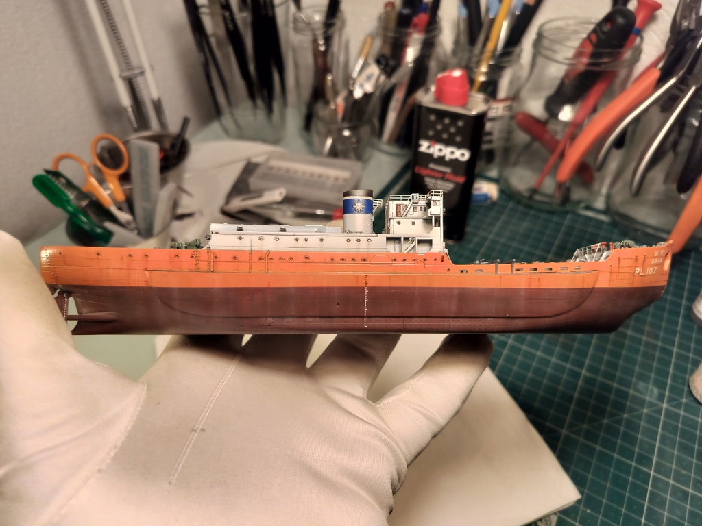

Mal_Belford Posted April 7 Author Posted April 7 Allright, this will have to do for me now,blaming it on firstimer with a modelship...LoL scvrobeson, denders, patricksparks and 4 others 7

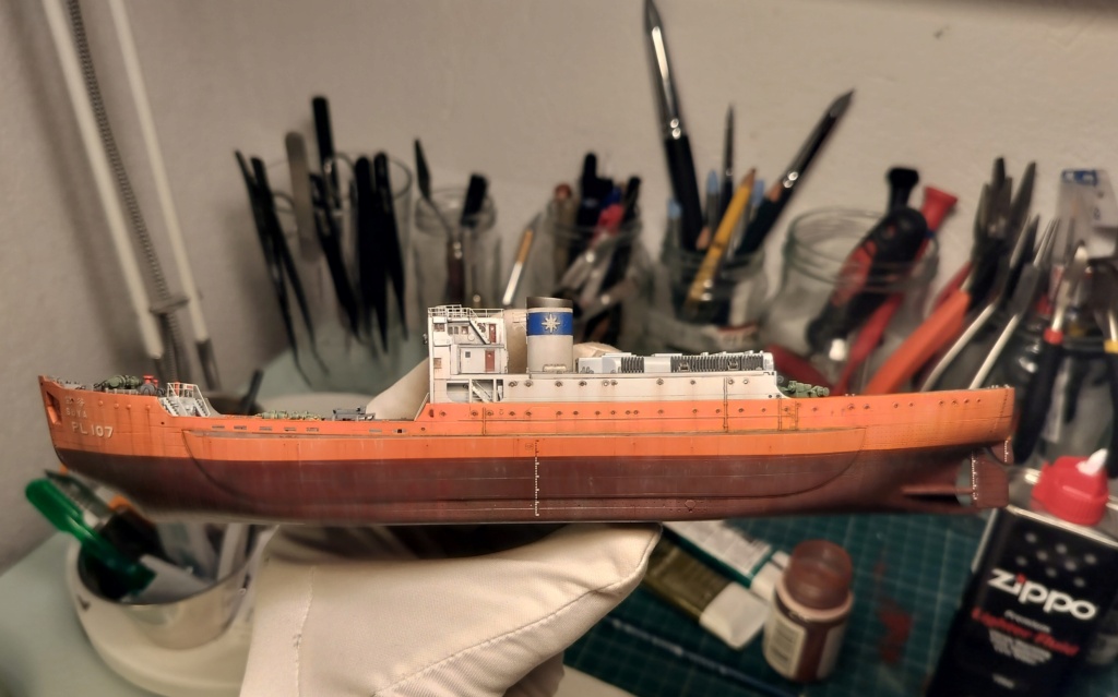

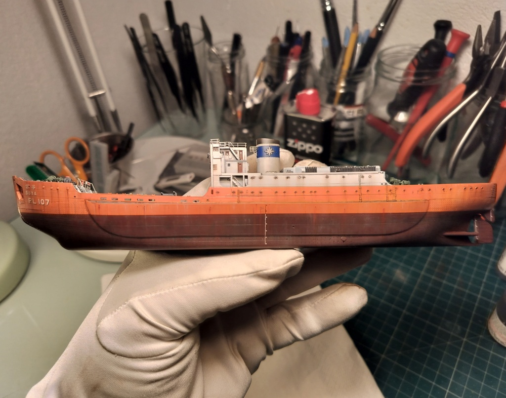

Mal_Belford Posted April 7 Author Posted April 7 (edited) Hull is finnished....masked of the orangea area, so to finnish of with flat/matte coat only on the hull red ( dont use flat that much at all) its needed, as it will be displayed in dry dock. This will do just fine for me. forgot to ad, will in the last ad water rinning marks on the hull, apply gloss on a finetip brush. Edited April 7 by Mal_Belford CODY, denders, Shoggz and 6 others 9
Javlin1 Posted April 7 Posted April 7 Looking good Mal I usually only weather above the waterline and lightly already moving out from me. Mal_Belford 1
Mal_Belford Posted April 7 Author Posted April 7 2 minutes ago, Javlin1 said: Looking good Mal I usually only weather above the waterline and lightly already moving out from me. Thank you for them kind words. needed to break up that monotone color, as it will be displayed in dry dock as mentioned earlier.

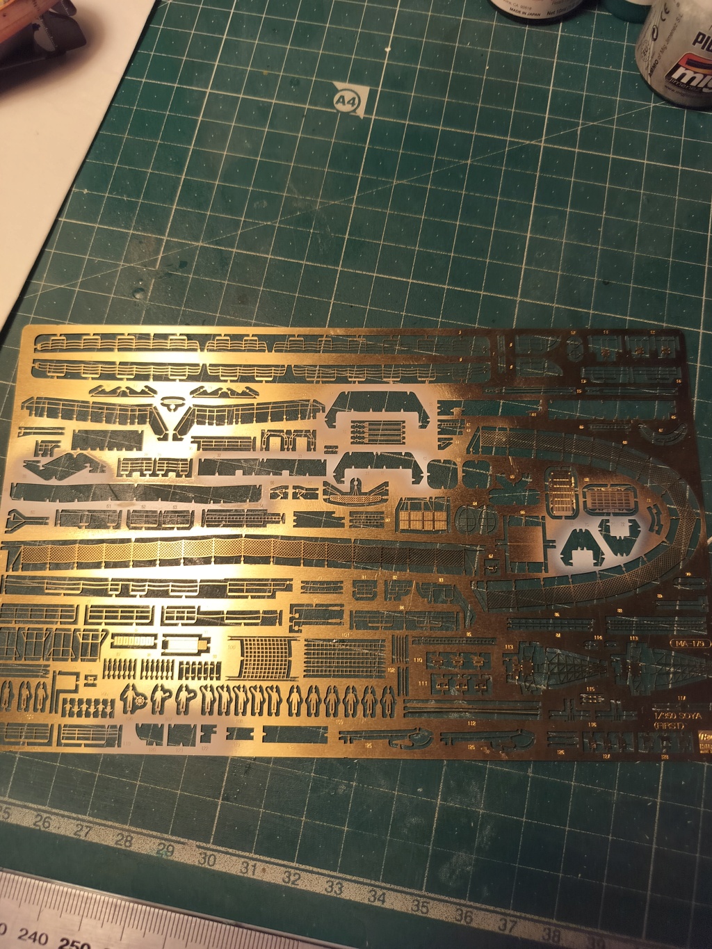

Mal_Belford Posted April 7 Author Posted April 7 (edited) This is the PE chart...lol for me it is ALOT...LoL. and yes, i mean no i wont use figures, no dogs, no pinguins/seals from that....all are crazy flat (of course its PE), make em more fattier using CA or PVA...nope, wont ad those...looks ridicioulus LoL. look like they were run over with a steam roller....or from a crime scene investigation, you know with white tape around LoL. Edited April 7 by Mal_Belford Javlin1, scvrobeson, TankBuster and 5 others 8

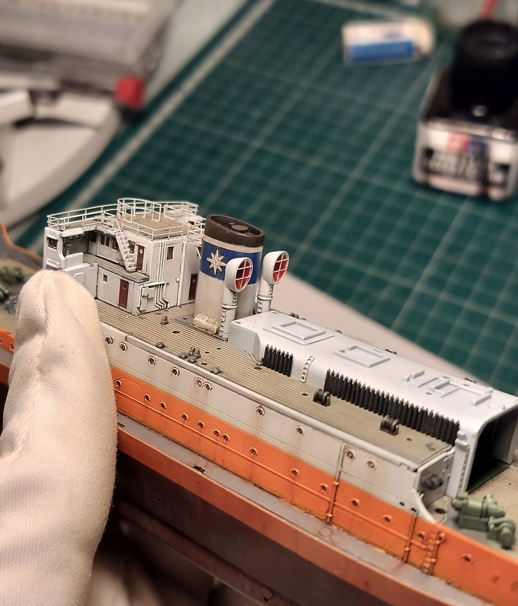

Mal_Belford Posted April 8 Author Posted April 8 Yep..them vent tubes in place, dunno what they are called in English. Shoggz, LSP_Kevin, Martinnfb and 5 others 8
Martinnfb Posted April 8 Posted April 8 Beautiful detail one those cowl vents Mal. Cheers Martin Mal_Belford 1

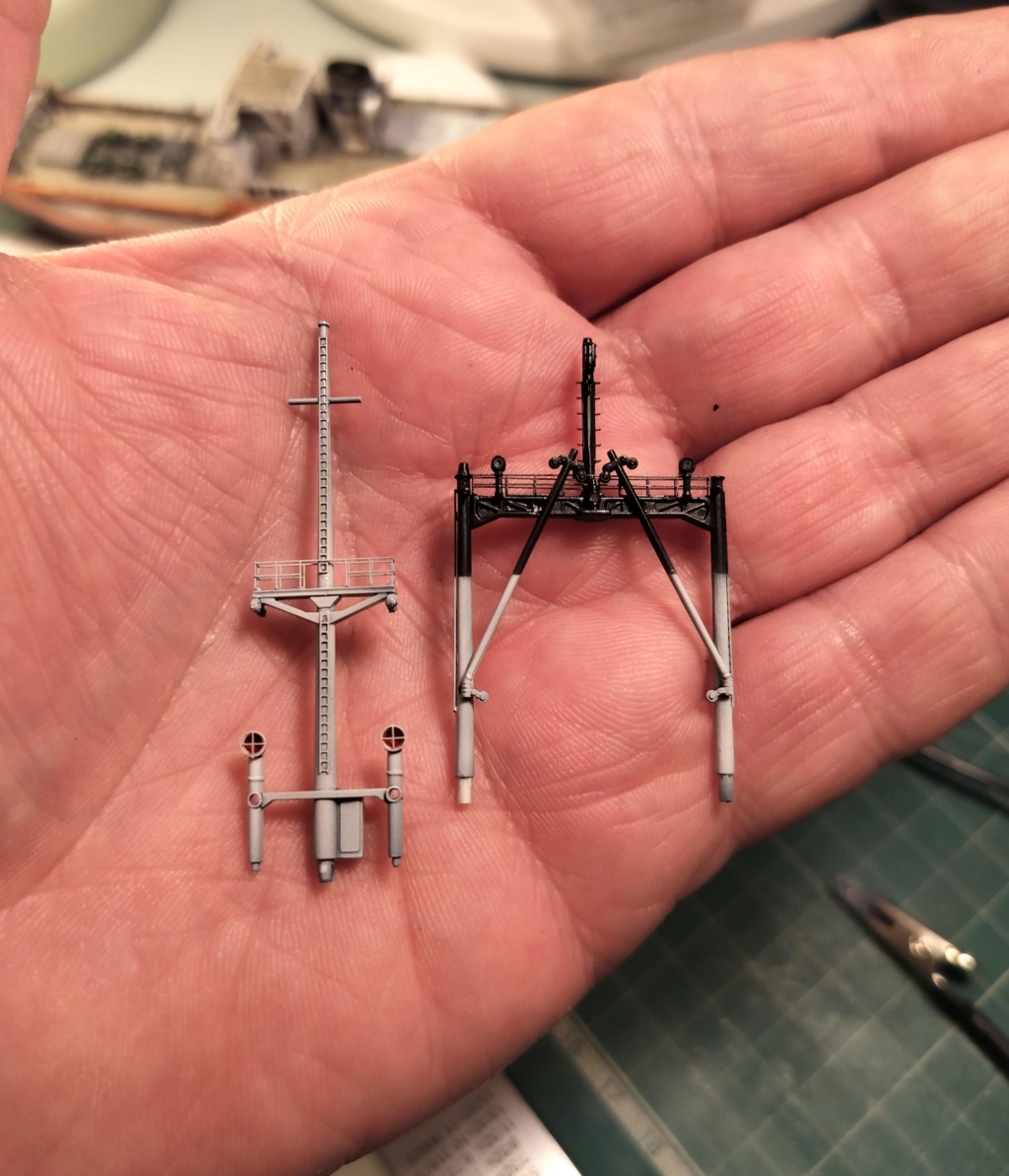

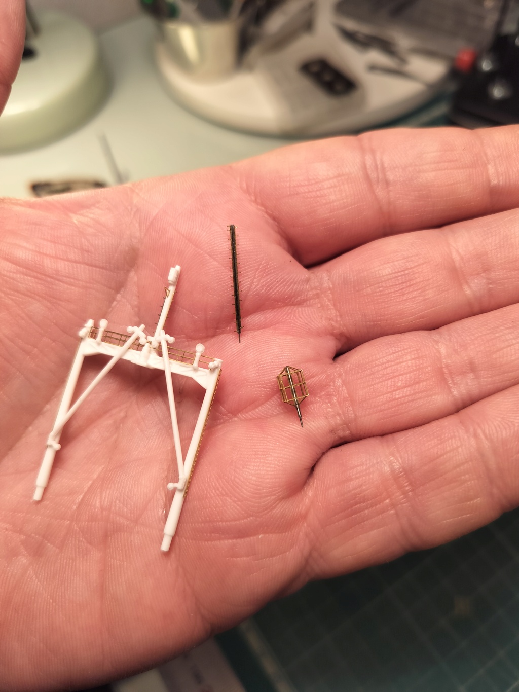

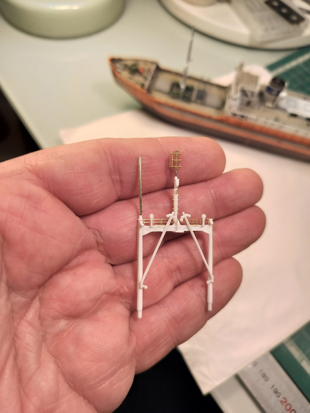

Mal_Belford Posted April 12 Author Posted April 12 Allright, little done this afternoon, well alot then, geez PE in 1:350 is fiddly to work with LoL.... Modified the stern masts, cut them away, replaced them with a injection needle and guitar string, drilled hole on them poles, attached ladders and antenna, reason, easy later assembly, as all this build gets more fragile every step, so later makes things easier for me. all is only dryfitted, yes it will work for me. LSP_Ray, Javlin1, patricksparks and 4 others 6 1
Javlin1 Posted April 12 Posted April 12 Looks great Mal some Nice scratch going on then this popped into my head ..........cat scratch Mal_Belford 1
Mal_Belford Posted April 12 Author Posted April 12 Allright, aaaaand paint. Painted em small vents red aswell. and yes clearcoated, now dry, weather theese little so it matches up with the rest of the ship. Javlin1, scvrobeson, LSP_Kevin and 3 others 6
