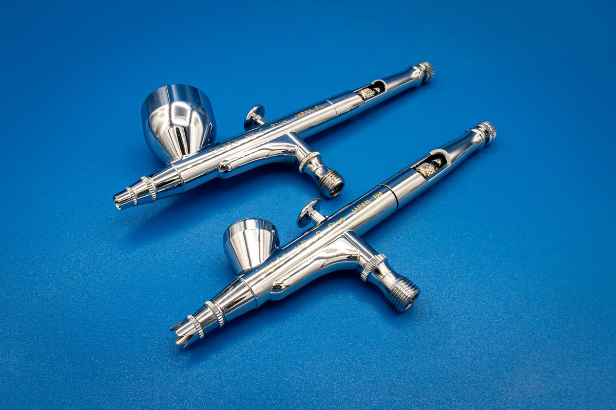

Thunnus Posted February 24 Posted February 24 I just replaced my SOTAR 2020 with an Iwata HP-B Plus for detail painting. I didn't use the SOTAR much but in situations where I absolutely needed a finer spray pattern than my workhorse Iwata HP-C Plus (3mm needle/tip), I would bust out the SOTAR (2mm needle/tip). It worked ok but it felt different in my hand than the Iwata in terms of ergonomics and balance and I had to get used to it each time. The last time I used it, something got stuck in the tip. I was able to remove the offending particle but the brush was never the same and I couldn't get it to stop chattering. So instead of trying to resolve the issue, I decided to replace it. The HP-B Plus is now my detail gun to augment my HP-C main brush. The SOTAR gets relegated to the storage bin, along with my Paasche H and V. LSP_Kevin, JayW, scvrobeson and 2 others 5

Thunnus Posted February 24 Author Posted February 24 14 hours ago, TankBuster said: Good choice, I have the C plus and brought the B plus for fine detail as well, and it does a lovely job of it. I also have 2 revolutions one is a .5 needle for big jobs and the other a .3 which I use for metalics, I also recently purchased crown cap and love it. Cheers. The crown cap was purchased for the C+ to try and squeeze more detail out of it. Now that I have the B+, I transferred the crown cap to the new brush and put the original cap back onto the C+. 10 hours ago, DrDave said: The trouble with a crown cap is you can’t use the blowback method for cleaning as you cant block the crown. True but I've found blowback to have some disadvantages so I stopped doing it anyway. 5 hours ago, Juggernut said: Ugh, I just decided I needed to have one of these too. Damn you John! I figured since I'm going to be doing fine Luftwaffe mottle camouflage as well as the fine reverse mottle on the He219 and Ju88's (night fighters) in 1/48 scale, I could probably get better results from this rather than my HP-CS with the .3 needle. I also have a 1/48 ICN Ki-21-1 Sally that has a very tight green over grey mottle camouflage that was taxing my brain on how to get it down without overspray. This also appears to have a MAC valve (excuse me if I'm using an incorrect term here). The little knurled knob at the end that limits needle travel so you get sonsistent lines which is a MUST for the reverse camouflage on the He219 and Ju88 night fighters. The best deal I found was The Merri Artist. Free shipping and no sales tax! Yup... I'm thinking about the Macchi 202 smoke-ring camo that I will be doing at some future point! TankBuster and Juggernut 2
