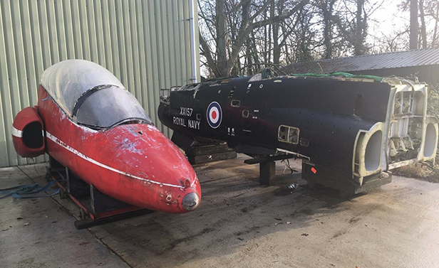

Victor K2 Posted February 2 Posted February 2 Hi Steve, XX154 operated at R.A.E. LLanbedr for a good few years that I worked there (86 till 2003). I always believed that there was no prototype Hawk and that 154 came straight off the production line. It did have a few differences to most of the Hawks. XX156, 157, 158and 159 were next off the production line. There wasn't any 155 registered. Derek is right in that 154 was never upgraded to the 2010 modification and was used to further the in production modifications. It had a lot more wiring than other Hawks when they were assessing the fatigue values. Though the test equipment was removed, the wiring wasn't. This made access to certain components challenging. We had 157 160 and 161 there at various times. They were used as shepherds for the Meteor Drones ( U16 version ) and Jindiviks. Later on, when 154 went back to Boscombe (I think ) we had ex Greek Airforce ( ex Luftwaffe ) Alpha jets. 156 ended up as Gate guard here at Valley. I am pleased to have worked on the very first Hawk T Mk1 and that 42 years on I am still working (putting in an appearance)on the Hawk T Mk1. The bacon slicers moved with the Tailplane and the guides forward and rear were fixed to the fuselage, but I bet you knew that look forward to the next update. Derek B and Stevepd 1 1
Derek B Posted February 2 Posted February 2 1 hour ago, Victor K2 said: Hi Steve, XX154 operated at R.A.E. LLanbedr for a good few years that I worked there (86 till 2003). I always believed that there was no prototype Hawk and that 154 came straight off the production line. It did have a few differences to most of the Hawks. XX156, 157, 158and 159 were next off the production line. There wasn't any 155 registered. Derek is right in that 154 was never upgraded to the 2010 modification and was used to further the in production modifications. It had a lot more wiring than other Hawks when they were assessing the fatigue values. Though the test equipment was removed, the wiring wasn't. This made access to certain components challenging. We had 157 160 and 161 there at various times. They were used as shepherds for the Meteor Drones ( U16 version ) and Jindiviks. Later on, when 154 went back to Boscombe (I think ) we had ex Greek Airforce ( ex Luftwaffe ) Alpha jets. 156 ended up as Gate guard here at Valley. I am pleased to have worked on the very first Hawk T Mk1 and that 42 years on I am still working (putting in an appearance)on the Hawk T Mk1. The bacon slicers moved with the Tailplane and the guides forward and rear were fixed to the fuselage, but I bet you knew that look forward to the next update. Hi Bob, Yes, '154 was the 'De Facto' prototype for the series, as it was the first of the production aircraft to fly, even if is was effectively always a pre-production development aircraft. I think that XX156 was a structural test airframe. You have had a magnificent career Bob - thank you for 'keeping the faith'. Cheers Derek Victor K2 and Stevepd 2

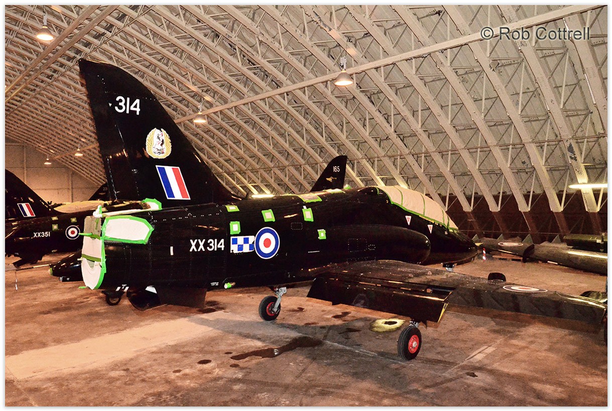

Stevepd Posted February 15 Author Posted February 15 (edited) Hi all. I've added the strengthening strips to the airbrake strakes. These are 1mm strips cut down to 0.5mm(ish) and one against the fuselage and the other butting up to it along the top of the strake. The 1:1 scale measured out at 2cm (0.46mm) for the upper and 1.5cm (0.46mm) for the lower strip. The gap at the rear of the strake to the end of the airbrake was 3in (2.38mm) and this is actually very close on the kit, so I left it. I've added the proud heat shroud to the GTS exhaust area. As you can see mine is straight down the center, when it is offset slightly to port. But I'd buttond it up prior to finding out. I've added the strengthening plates around the fuel dump. Also I offered up the kit fairing under the rudder which is the correct length, but now doesn't follow the profile now the Fred sutton rear end has been adjusted. I put yellow card to show the gap. Right from the start I really wanted to display the tailplane actuator. Now you can imagine how much info there isn't out there. So, from the cutaway drawings and a side shot from the Hawk sales brochure, I've made this (below). I think it's a little agricultural but I think it's OK. I've taken off the heavy surround from the fairing, which will obviously be off the displayed aircraft. I've drilled out the solid bit of plastic at the bottom of the fin as I found a photo of the cutout. Does anyone have any info that could help me decide how much area to cut away under the rudder to fit the actuator. If not, I'll have to guess. So 2 questions; - is there any formed structure inside the fillet under the rudder. Or is it hollow and it just screws down to the fuselage via the flange?. How much material to remove to get the actuator in. Is it opened up past where the actuator housed?. Thanks all. Edited February 15 by Stevepd Greg W, Derek B, Landrotten Highlander and 3 others 6
Derek B Posted February 15 Posted February 15 3 hours ago, Stevepd said: Hi all. I've added the strengthening strips to the airbrake strakes. These are 1mm strips cut down to 0.5mm(ish) and one against the fuselage and the other butting up to it along the top of the strake. The 1:1 scale measured out at 2cm (0.46mm) for the upper and 1.5cm (0.46mm) for the lower strip. The gap at the rear of the strake to the end of the airbrake was 3in (2.38mm) and this is actually very close on the kit, so I left it. I've added the proud heat shroud to the GTS exhaust area. As you can see mine is straight down the center, when it is offset slightly to port. But I'd buttond it up prior to finding out. I've added the strengthening plates around the fuel dump. Also I offered up the kit fairing under the rudder which is the correct length, but now doesn't follow the profile now the Fred sutton rear end has been adjusted. I put yellow card to show the gap. Right from the start I really wanted to display the tailplane actuator. Now you can imagine how much info there isn't out there. So, from the cutaway drawings and a side shot from the Hawk sales brochure, I've made this (below). I think it's a little agricultural but I think it's OK. I've taken off the heavy surround from the fairing, which will obviously be off the displayed aircraft. I've drilled out the solid bit of plastic at the bottom of the fin as I found a photo of the cutout. Does anyone have any info that could help me decide how much area to cut away under the rudder to fit the actuator. If not, I'll have to guess. So 2 questions; - is there any formed structure inside the fillet under the rudder. Or is it hollow and it just screws down to the fuselage via the flange?. How much material to remove to get the actuator in. Is it opened up past where the actuator housed?. Thanks all. There isn't a lot out there online Steve. The trailing edge fin fairings are hollow fairing attached to the fuselage structure and fin (they allow rotation of the tailplane via the PCU actuator and drive lever bracket attached to the top of the tailplane). http://www.clubhyper.com/reference/hawkdm_2.htm https://www.jetartaviation.co.uk/bae-astra-hawk-xx341 https://www.demobbed.org.uk/images.php?s=d&type=544 Derek Victor K2, Stevepd, Landrotten Highlander and 3 others 5 1
Stevepd Posted February 15 Author Posted February 15 2 hours ago, Derek B said: There isn't a lot out there online Steve. The trailing edge fin fairings are hollow fairing attached to the fuselage structure and fin (they allow rotation of the tailplane via the PCU actuator and drive lever bracket attached to the top of the tailplane). http://www.clubhyper.com/reference/hawkdm_2.htm https://www.jetartaviation.co.uk/bae-astra-hawk-xx341 https://www.demobbed.org.uk/images.php?s=d&type=544 Derek Thanks for replying Derek. That's all useful info and more than I'd had previously. I did find that clubhyper site last night but zooming in it gets so pixilated, it's guess worthy. Think I've got enough to get by. I've clocked that small white vertical structure on the exhaust fairing join. Do you think that's on the newer rear end you mention earlier inthe build or on all of them. I note that it's present only in some, so may have been removed..... Steve.
