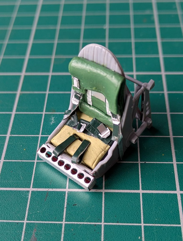

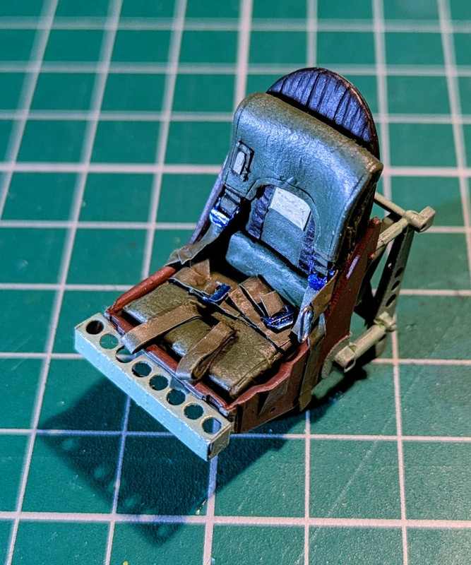

geedubelyer Posted November 20, 2024 Author Posted November 20, 2024 Thanks guys, I hope you enjoy the build. This is not likely to be as in-depth as the previous thread but I will try to include everything that differs from the norm. Here are a couple of snaps of the painted seat. Looking at the buckles in the cold light I should have bought myself some aftermarket modern belts with etched hardware. The only saving grace might be that when viewed through the canopy they don't appear as wonky! LSP_Kevin, Rocat, Gazzas and 12 others 15

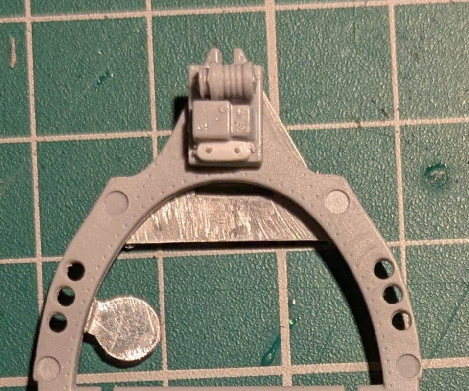

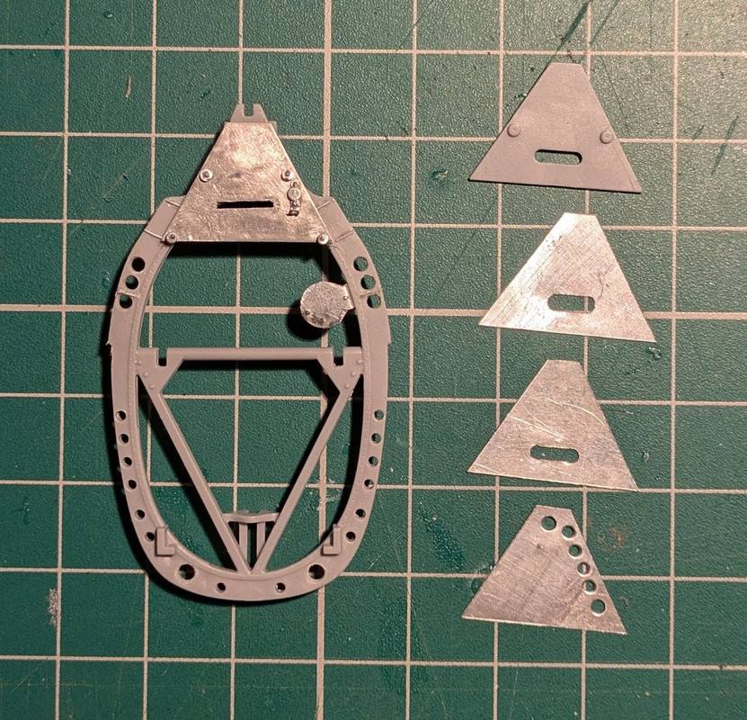

geedubelyer Posted November 24, 2024 Author Posted November 24, 2024 (edited) Thank you folks. I appreciate your support very much. I have been adding a little detail to the bulkhead. A couple of things differ from an aircraft in period. There is no armour plate behind the seat on this aircraft and no head pad either. Another small detail is the opening for the belts is more of a slit than the oval shape that Airfix provide. I began to scratch build a replacement but spotted the difference in the opening after a couple of tries. The other versions are not the correct shape. I don't know what the circular disc is. As you can see I took a minute to drill out the lightening holes plus added a couple of small strengthening ribs to the face of the bulkhead which are obvious on the real deal. On the rear of the bulkhead I added a couple of small details to the plastic part. Hopefully I can pick these out with some paint. Edited November 24, 2024 by geedubelyer Rocat, Stevepd, Dpgsbody55 and 11 others 14

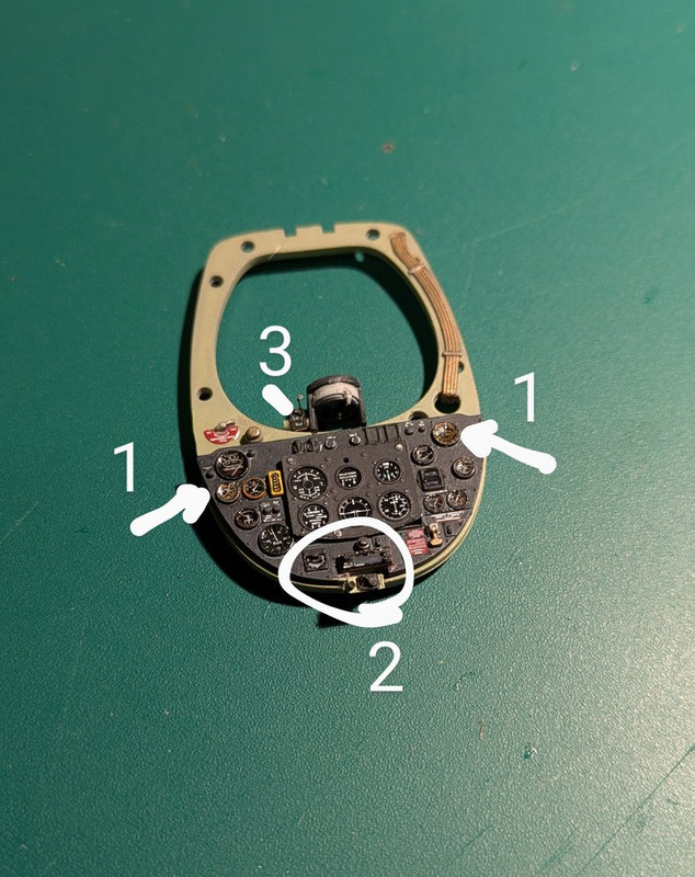

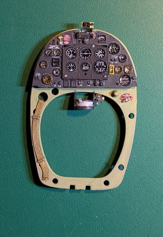

geedubelyer Posted December 9, 2024 Author Posted December 9, 2024 (edited) Turning my attention to the IP next before I begin the detail painting of the cockpit sidewalls. When I researched MK356 I couldn't find any specific images of her instrument panel. I did however find a couple of other BBMF Spitfire IP pics. These showed that the gunsight was removed and some modern electronic boxes were placed in the same spot. These were scratch built but they're rough. See#2 This is one of those occasions where the modern technology of 3D printing would have been an absolute boon. The boxes are quite simple in shape and would probably have been pretty easy to design. They are also small even in this scale and quite difficult to scratch build neatly. I keep repeating my mantra....."the canopy will be closed, the canopy will be closed" Another slight issue resulted from the clear plastic part settling scew-whiff as it dried. Although I laid the part on a horizontal surface it looks like the clear part floated out of position as the small pool of glue cured. This means the instruments aren't level. It's not enormously obvious except from directly head on and we have to remember "the canopy will be closed" The placards are out of the box as are the instrument face decals except for the blind flying panel which was borrowed from an Airscale Mk 1/Vb set I had. MK356 has the arch shaped blind flying panel but the kit depicts the rectangular version. I'm not convinced by the colours of some of the Airfix instrument decals but didn't have any others to hand. These will do because "the canopy will be closed" The last piece I made was the fuel selector lever to the right of the compass. This little panel is quite obvious and a surprising omission by Airfix. See#3 Lastly for this update a few thoughts on the kit parts for anyone considering going totally OOTB. The instrument decals I actually used didn't fit the dial openings very well. They are all slightly oversized resulting in a dished effect to the instrument face. This is compounded by any gloss clear coat applied to give the appearance of glass because the fluid meniscus increases the unwanted bowl shape. See#1 My recommendation would be to use the Airscale set even if the canopy is going to be closed. You'll be glad you did. Cheers. Guy Edited December 9, 2024 by geedubelyer RBrown, Greg W, MikeC and 12 others 15

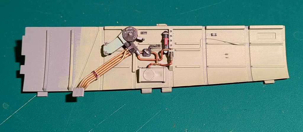

geedubelyer Posted December 11, 2024 Author Posted December 11, 2024 (edited) @mozart & @Shoggz, thanks both. I appreciate the encouragement and support. We are indeed our own worst critics at times and it is learning to live with what we are capable of that is the challenge. Over time I am becoming increasingly more forgiving of myself particularly in this instance because the canopy will be closed Here's a look at the sidewalls so far. During my previous Airfix Spitfire build I really went to town adding detail only to discover that much of it was either obscured or invisible. This time I've concentrated on picking out the kit details with paint. It should look reasonable when it's finished. Cheers. Edited December 11, 2024 by geedubelyer Shoggz, patricksparks, Elger and 15 others 18
