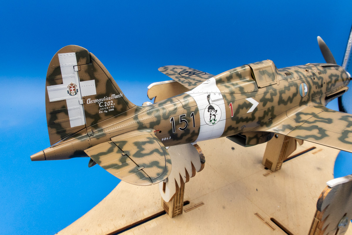

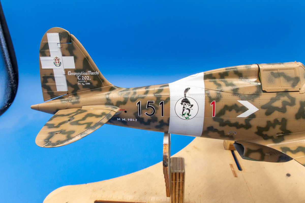

Shoggz Posted April 7, 2025 Posted April 7, 2025 That's really lovely - your finishing skills are exemplary John. ..and yes, the wrinkling of the decals after a dose of Sol is one of the ultimate modelling 'hold your nerve' moments! Thunnus, Biggles87 and Paulpk 2 1

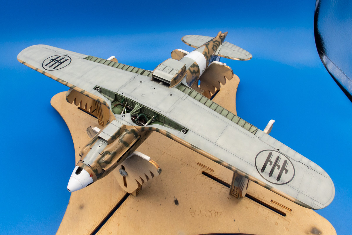

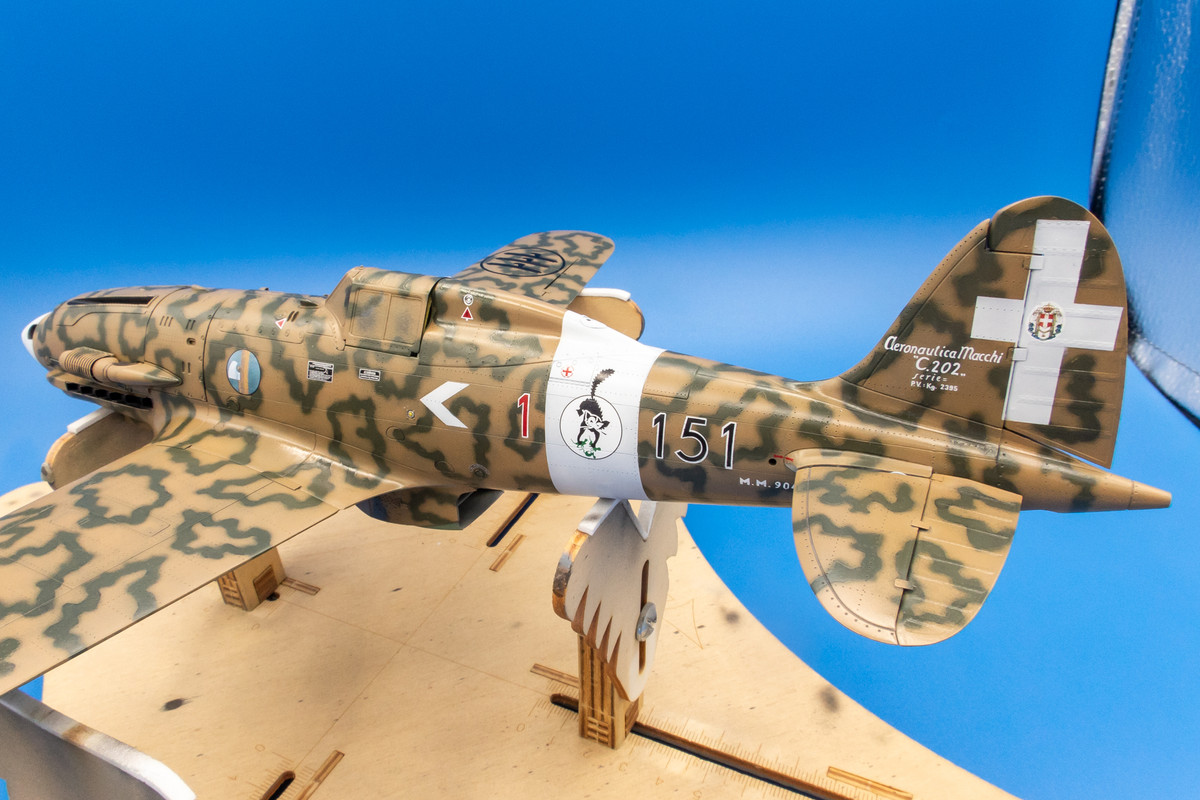

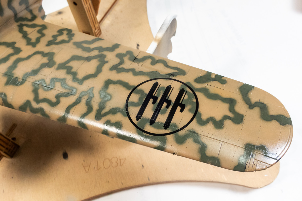

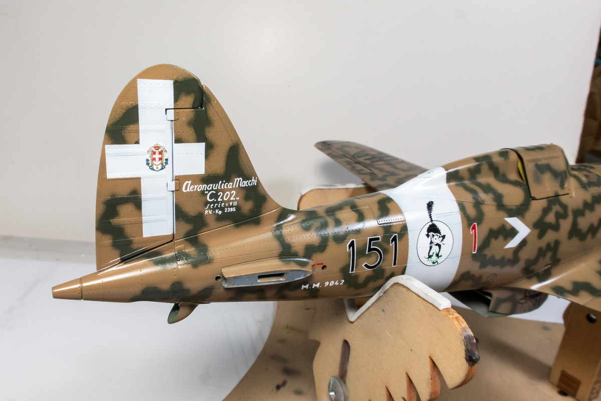

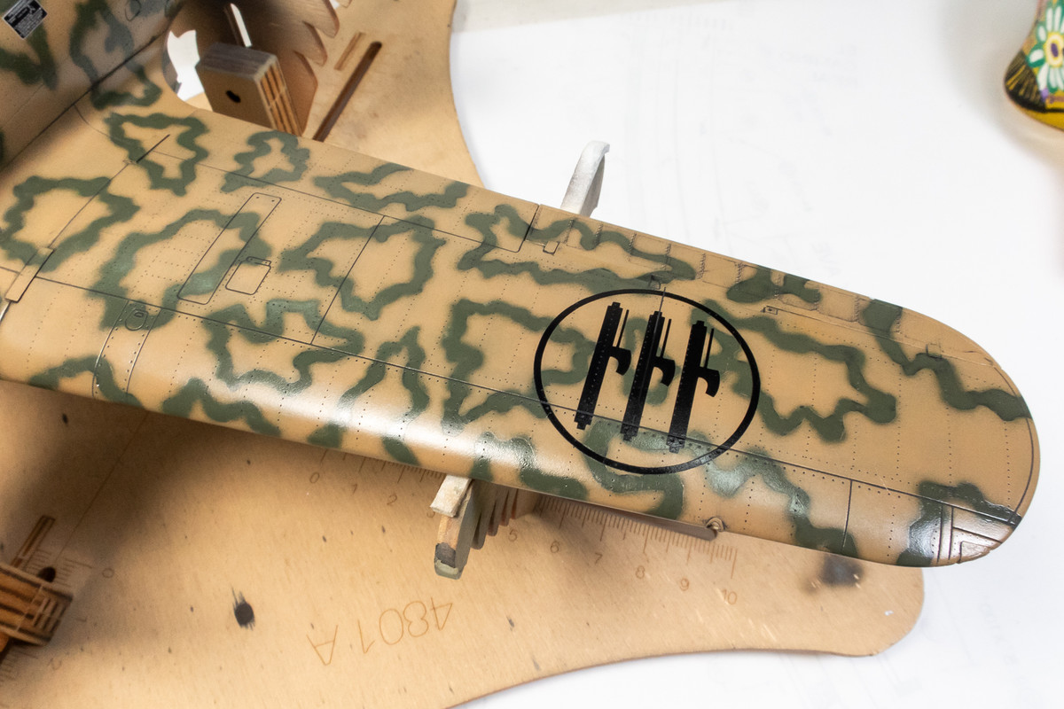

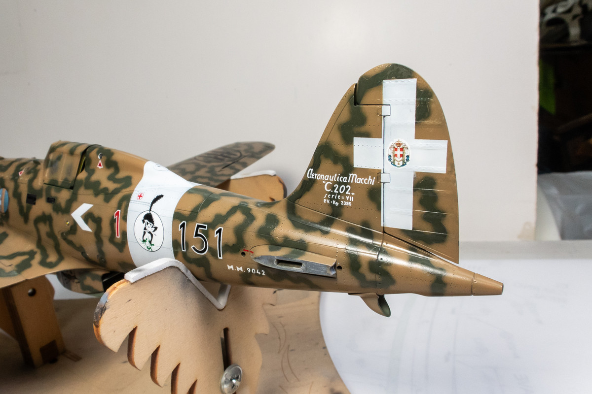

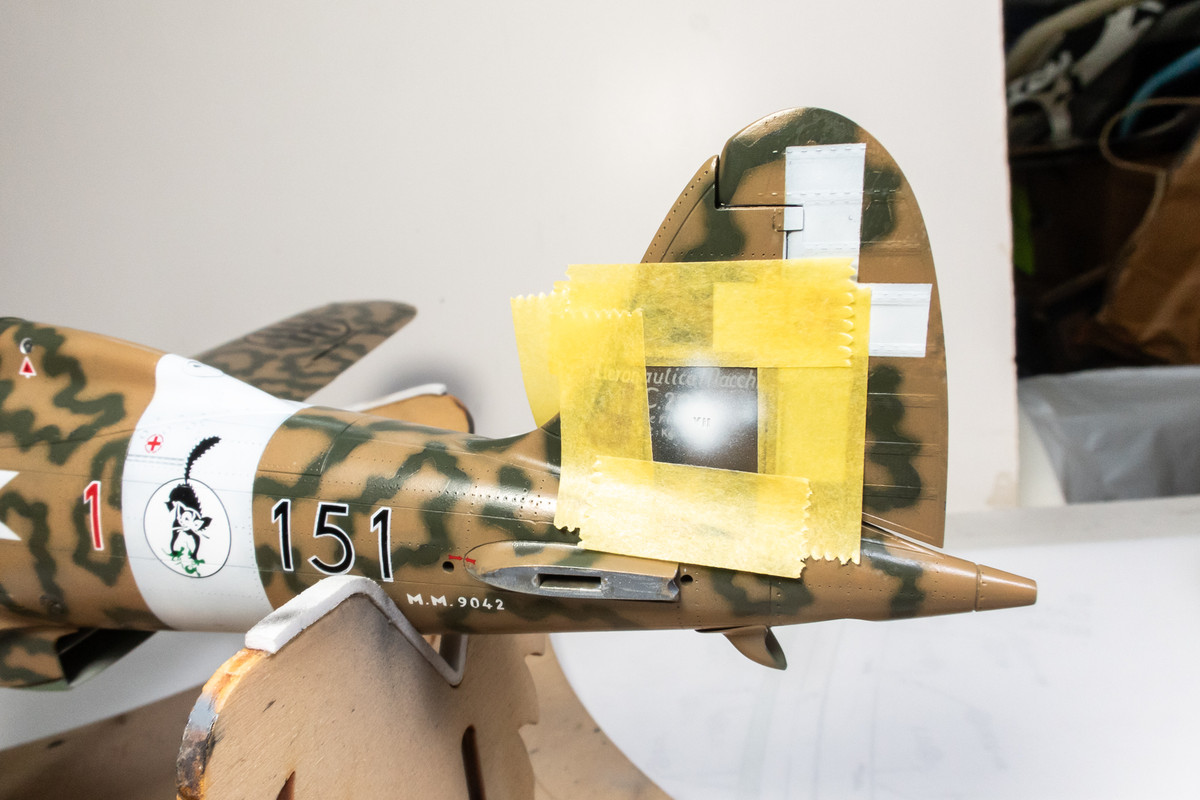

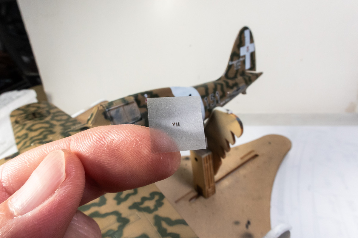

Thunnus Posted April 7, 2025 Author Posted April 7, 2025 Thank you Richard! Still lots of work to do as the weathering has not yet started. The decals are done. I will seal the decals with gloss and add that final little "VII" to the tail stencil and then we'll begin the weathering process. amurray, Dpgsbody55, patricksparks and 24 others 27

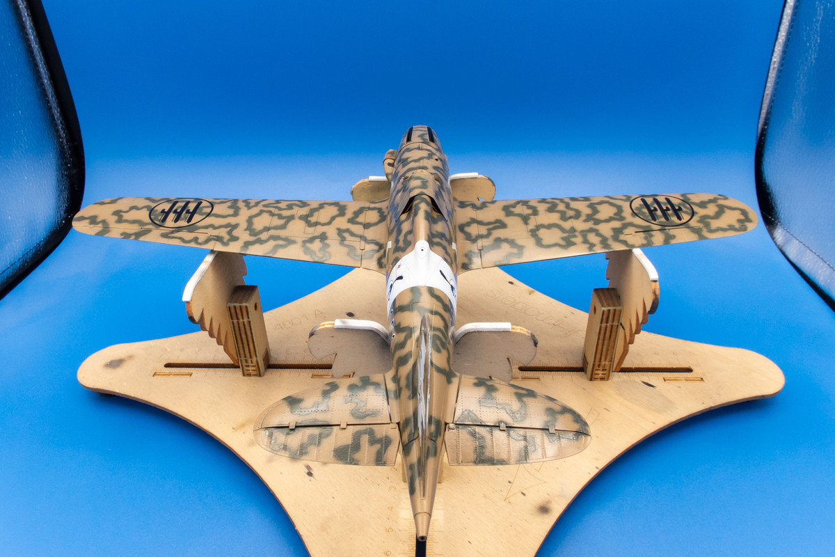

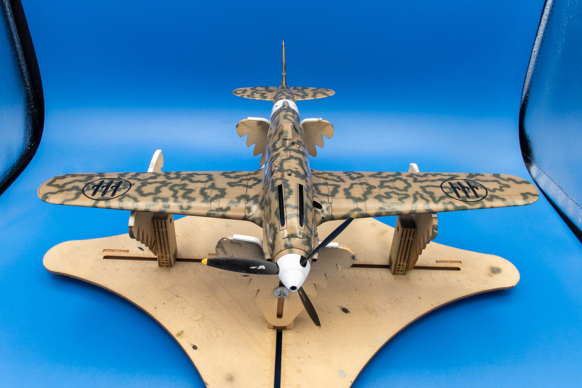

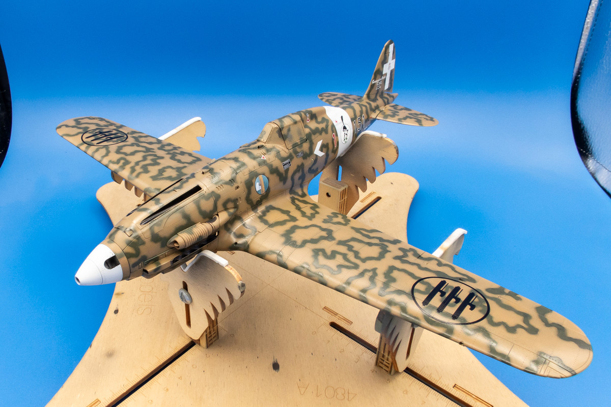

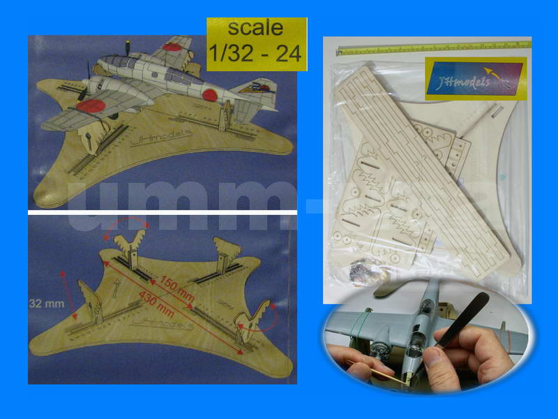

JayW Posted April 7, 2025 Posted April 7, 2025 (edited) Will be an Italian masterpiece. John - you are a dedicated user of that stand for your model finishing (at least). I wonder if it can be expanded to accomodate a model 32/18 = 1.78 times the length and width. Ya think? Edited April 7, 2025 by JayW Thunnus 1

Thunnus Posted April 8, 2025 Author Posted April 8, 2025 7 hours ago, JayW said: Will be an Italian masterpiece. John - you are a dedicated user of that stand for your model finishing (at least). I wonder if it can be expanded to accomodate a model 32/18 = 1.78 times the length and width. Ya think? Not sure about masterpiece but that smoke ring camo will be checked off the bucket list! I'm sure it would be pretty easy to fabricate a jig to suit using 3D-printing, no? The one I am using is classified for 1/48-1/32 scale aircraft so there is a bigger one (1/32-24) available... The larger one can stretch from 150mm to 430mm (6"-17"). I measure mine and it stretches 3.7" to 11.6". Not quite the 1.78X you are looking for. These jigs are available at UMM-USA. I want one like what Jeroen has... 7 hours ago, LSP_Kevin said: Thanks, John. The reason I turn to Aqua Gloss occasionally is to take advantage of its relatively inert water-based properties, when other types may cause unwanted effects - I'm thinking of natural metal finishes or fragile decals here. So thinning it with MLT kind of goes against my purpose here! Good to know it can be done, though. Kev Ahhh... got it! Aqua Gloss + MLT does need care when using for sure. scvrobeson, Philbucknall, Shoggz and 4 others 5 2

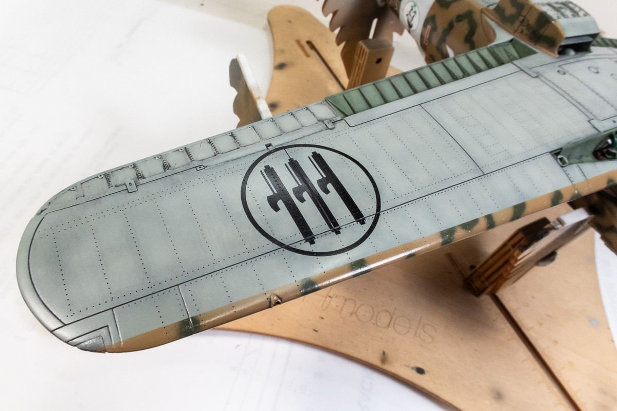

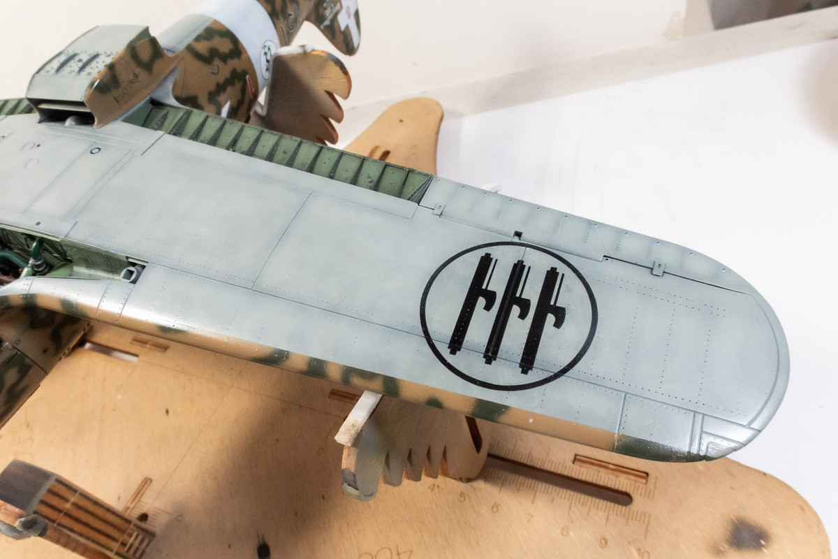

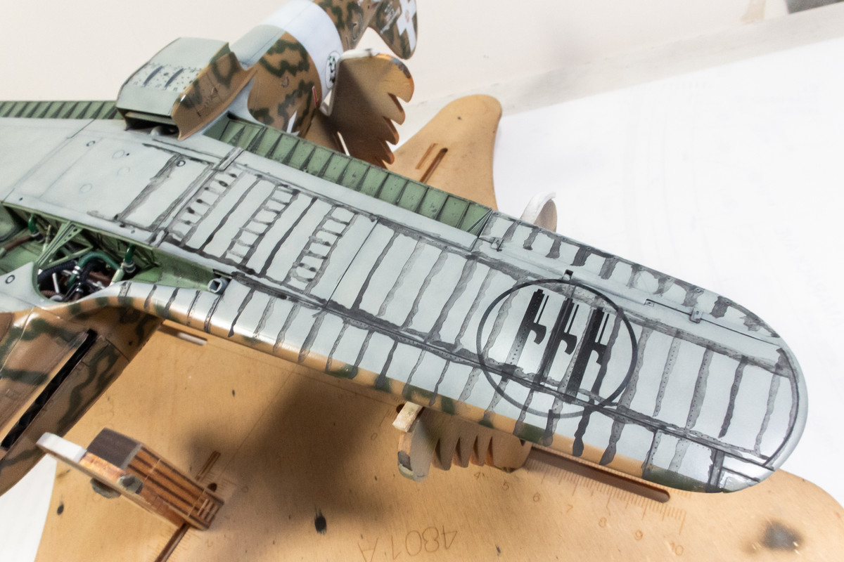

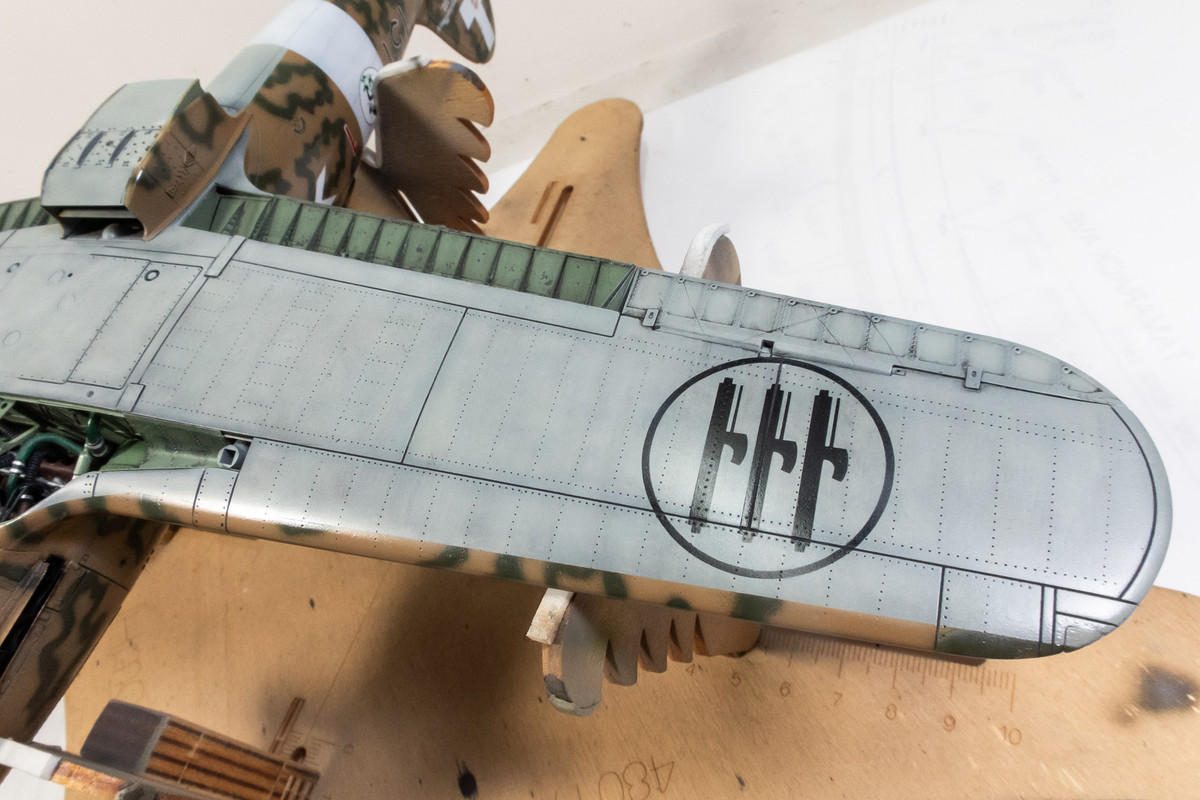

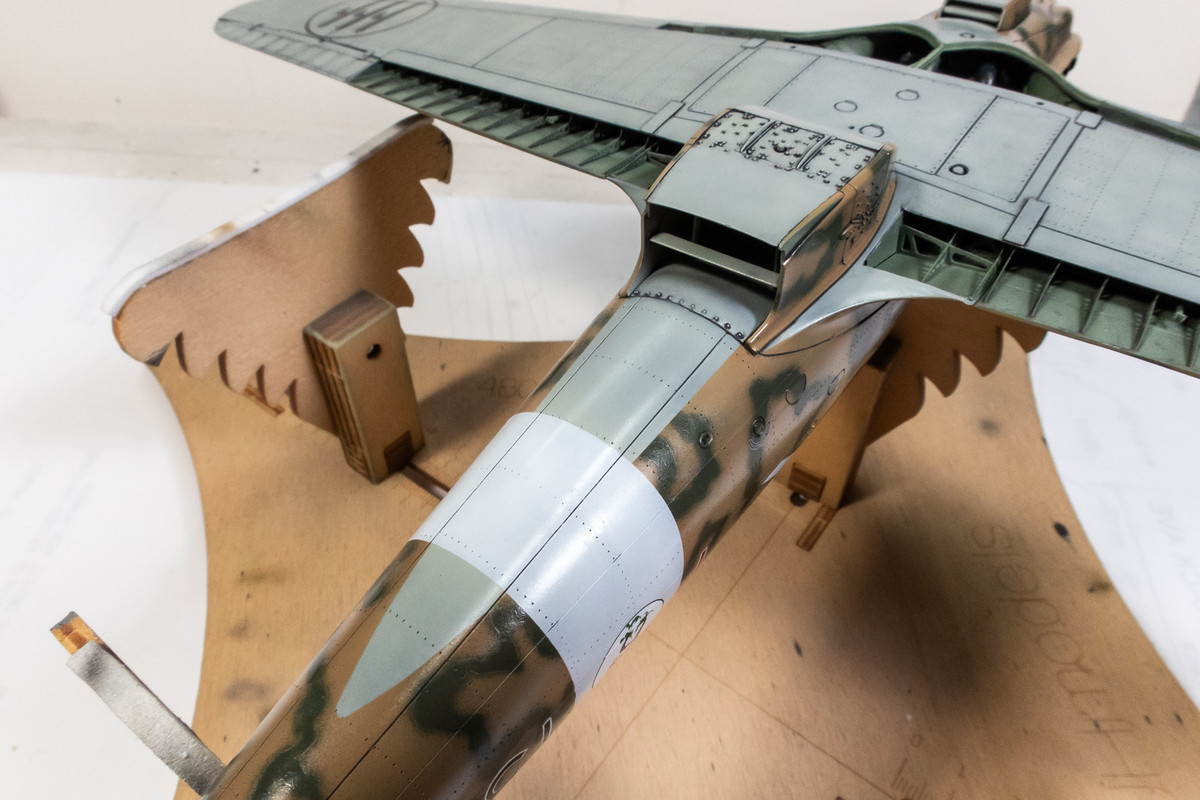

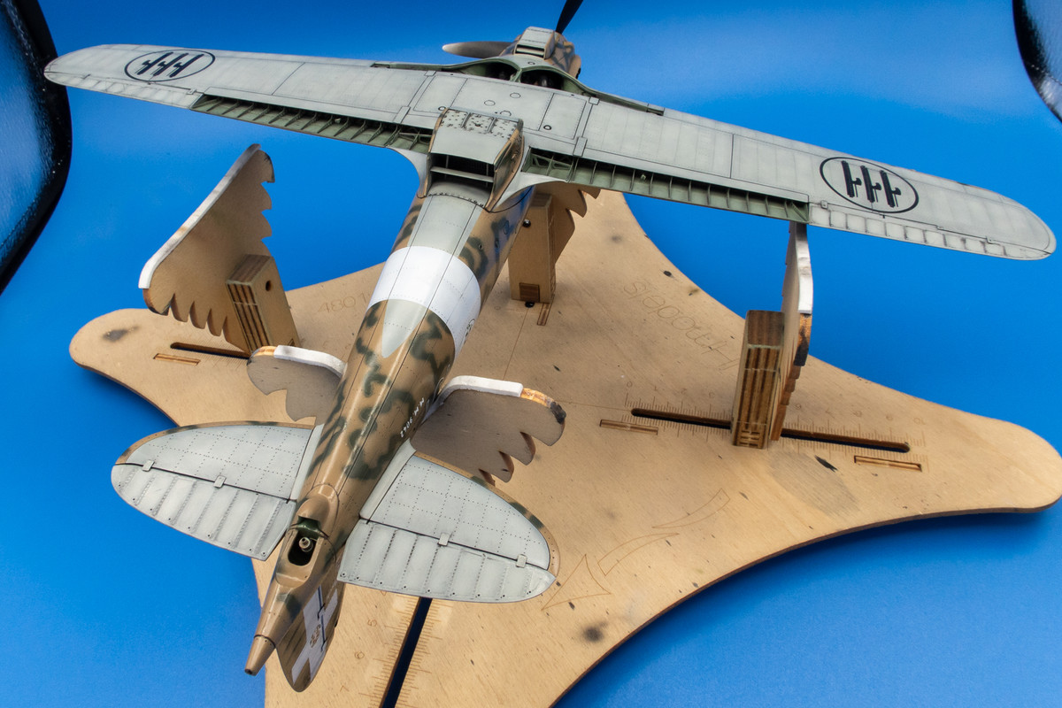

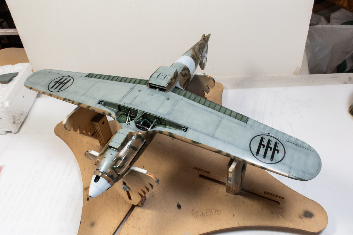

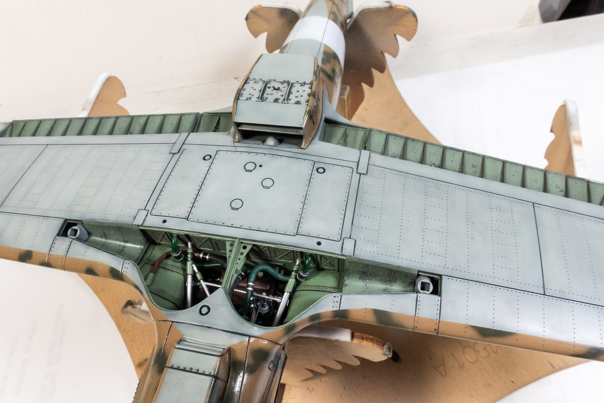

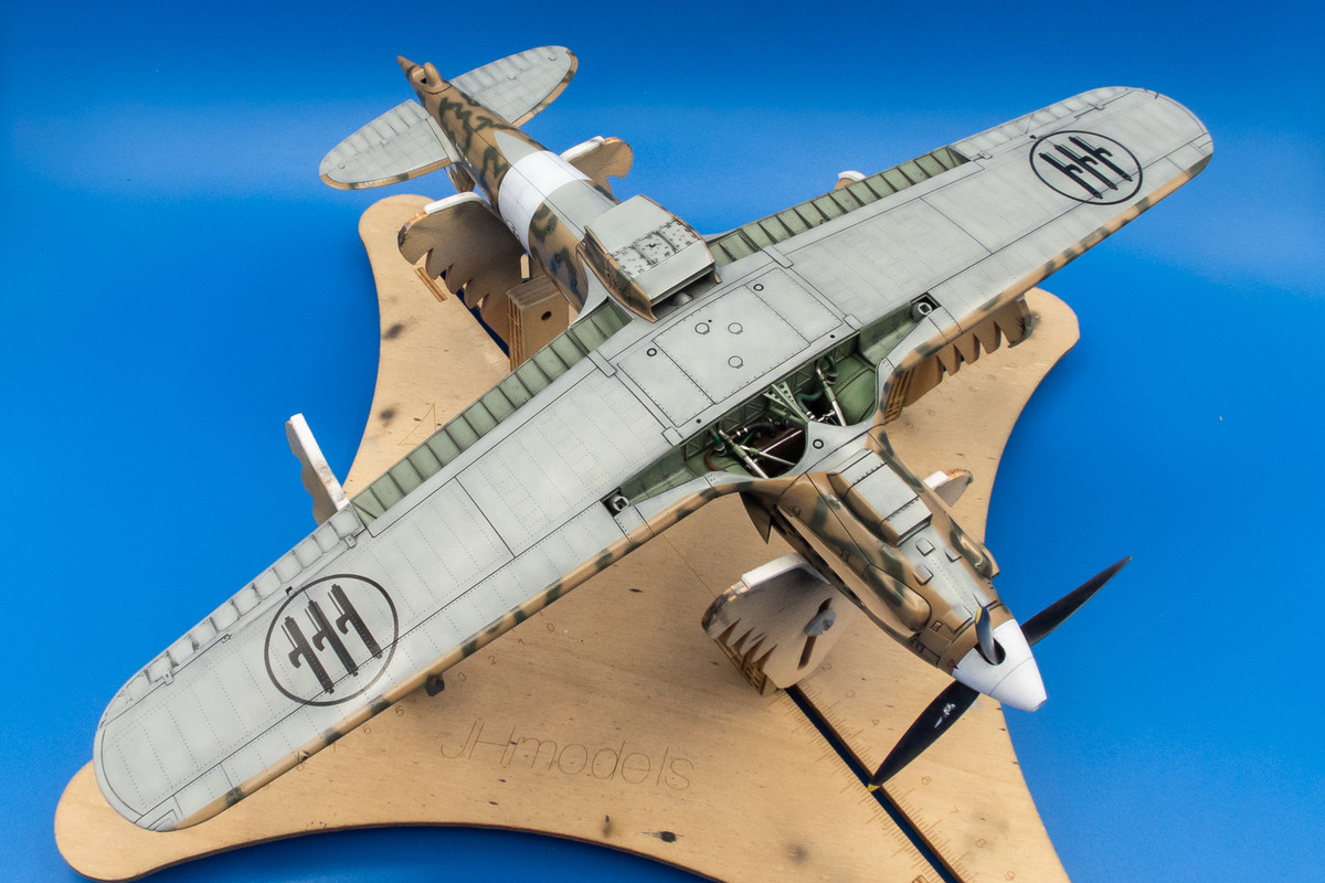

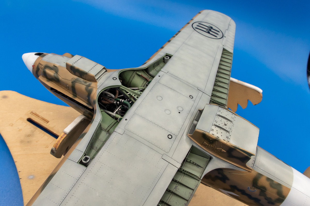

Thunnus Posted April 8, 2025 Author Posted April 8, 2025 (edited) 6 hours ago, Hubert Boillot said: Interesting discussion about Aqua Gloss. It’s currently difficult to fetch in Europe, but Mig Jimenez seems to have comparable alternatives. One interesting feature of Aqua Gloss is that it can be thinned with water. And therefore used on MRP paints and metallic colors without the adverse effects of using IPÀor MLT, both of which are quiet agressive against MRP paints (ask me how I know …) As for the Macchi, it’s another true masterpiece in the making 👍! Hubert Thank you Hubert! Does spraying Aqua Gloss thinned with water keep the high shine finish of colors like Alclad Chrome intact? Will have to test that out! 6 hours ago, Branko said: Beautifull, simply beautifull. Thank you very much! The decals have been sealed with a gloss coat so now it is time for the first weathering step. I will be applying a pastel wash to highlight all of the recessed detail, including the rivets that were applied manually at the beginning of this build. We'll start off with the undersides first. You can make out the tonal variation of the Light Grey that was applied over the mottle pre-shade layer. The gloss coat, thinned with Mr Leveling Thinner actually brought more of the pre-shading to the surface and I had to spray some more Light Grey to dial that effect back. My pastel washes are homemade with scrapings from pastel chalks mixed with water... super simple and very effective. I am choosing a grey color for the wash. The wash is run over all of the panel lines and rivets and allowed to dry. The surface is then wiped with a damp cloth to remove the wash that is not stuck in the recessed areas. I typically do the wash application sections at a time to keep track of where the wash has been applied and more importantly, where it needs to be removed from. It's easy to lose track leave some wash unwiped, which really detracts from the overall presentation. Before I continue the wash on the upper sides, it is time to fill in the Series number using my wee VII mask. Thankfully, the Oramask 810 material is translucent, making it easier to place in the exact spot. Gotta be careful since the mask is going over a decal. Such a small detail but it removes the nagging thought in my mind if I had left it as an erroneous "XIII". Ok, on to the upper side pastel wash. I'm going to try the same grey color that was used on the bottom. The effect is noticeable but not too stark. I think this will work. I'm going to stop here and continue with the wash on the fuselage later. Edited April 8, 2025 by Thunnus LSP_Kevin, amurray, Dennis7423 and 19 others 20 2
Javlin1 Posted April 8, 2025 Posted April 8, 2025 That is looking beautiful Sir and appreciate the the cue on the wash.

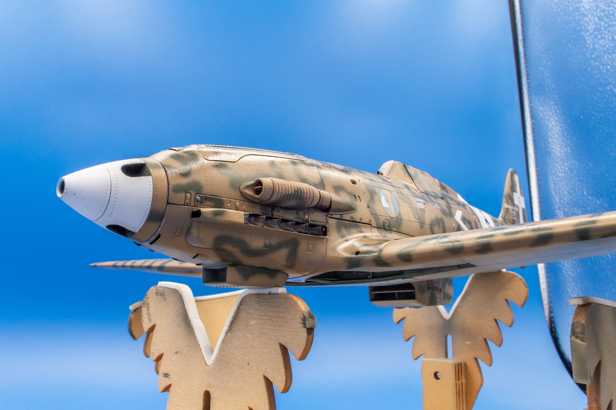

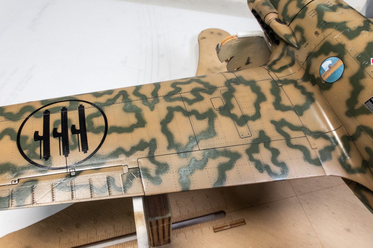

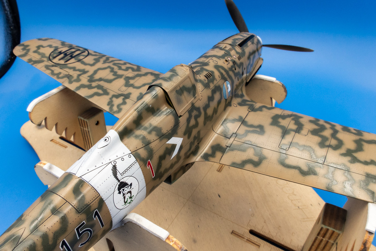

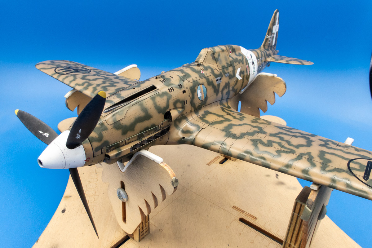

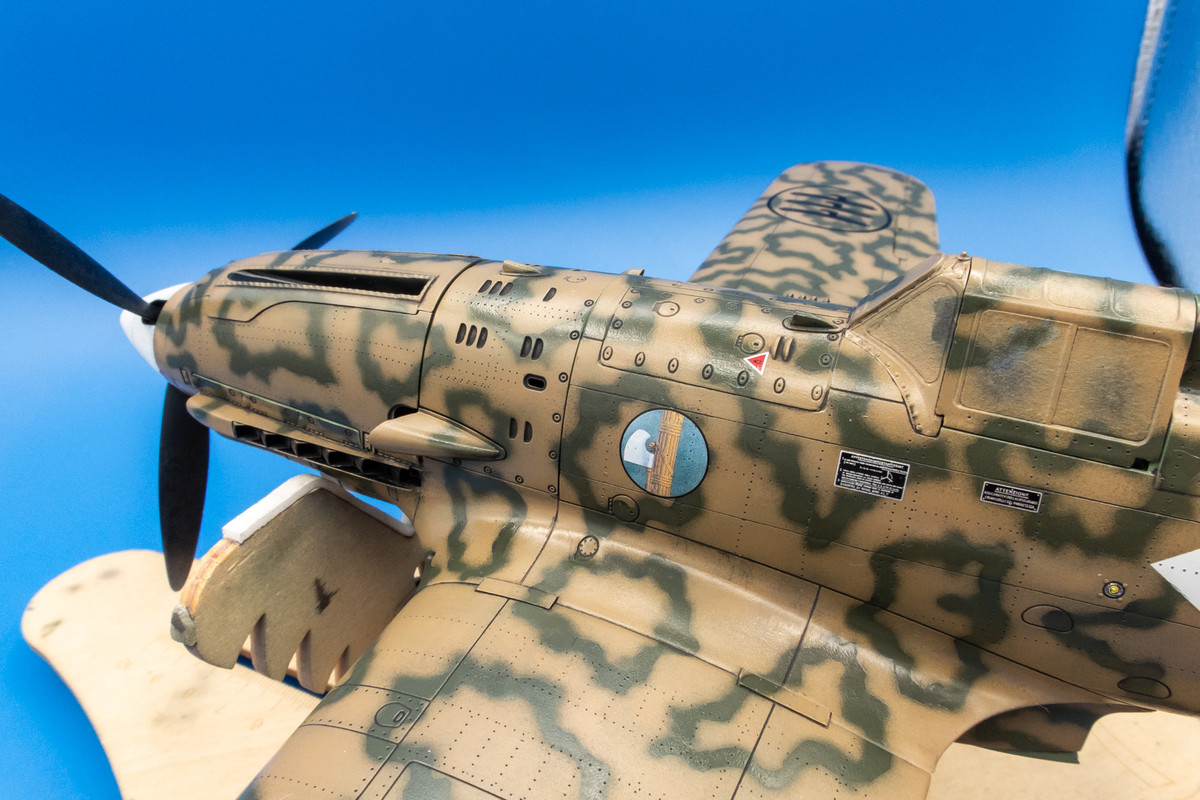

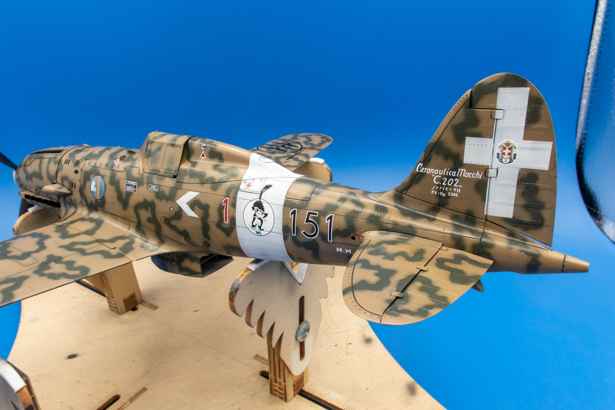

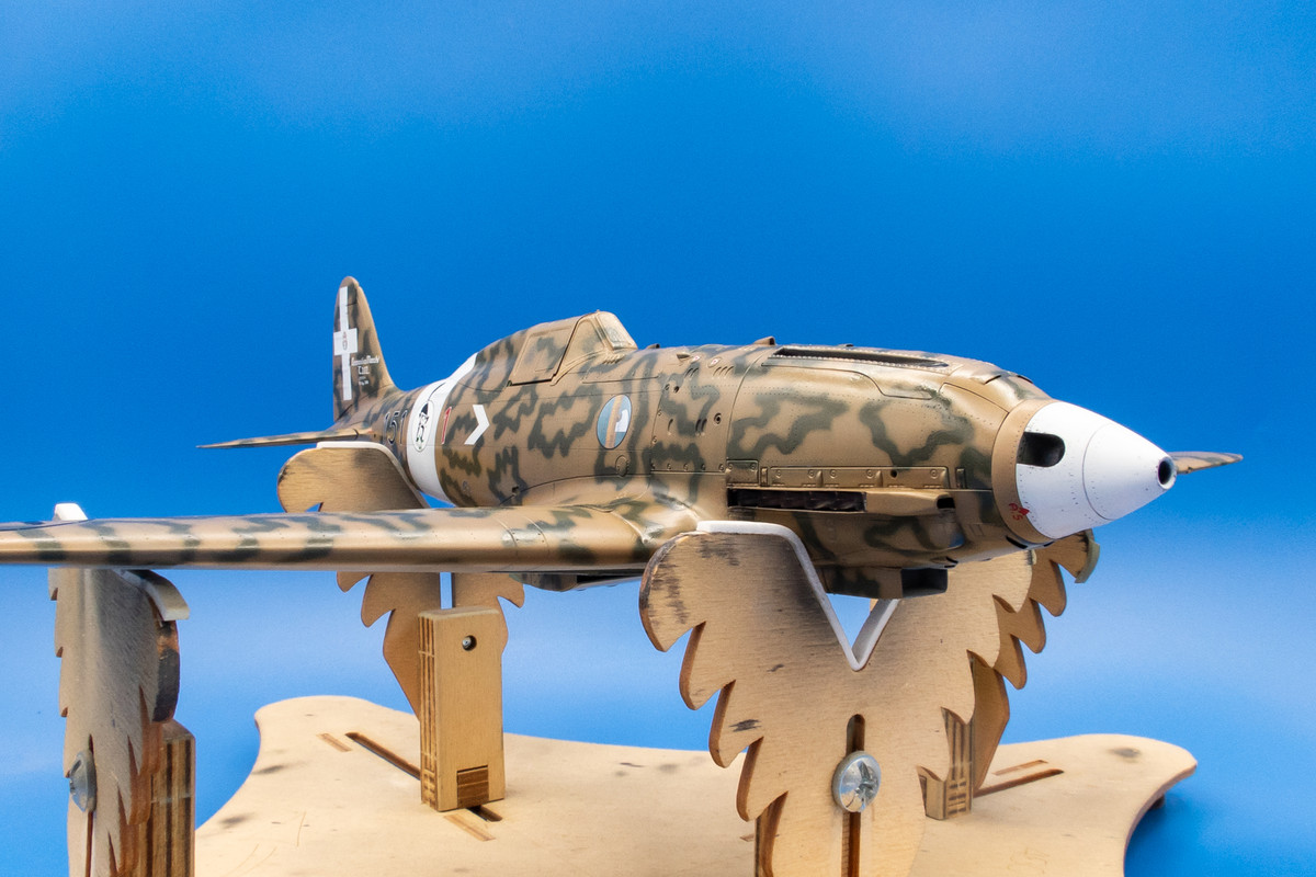

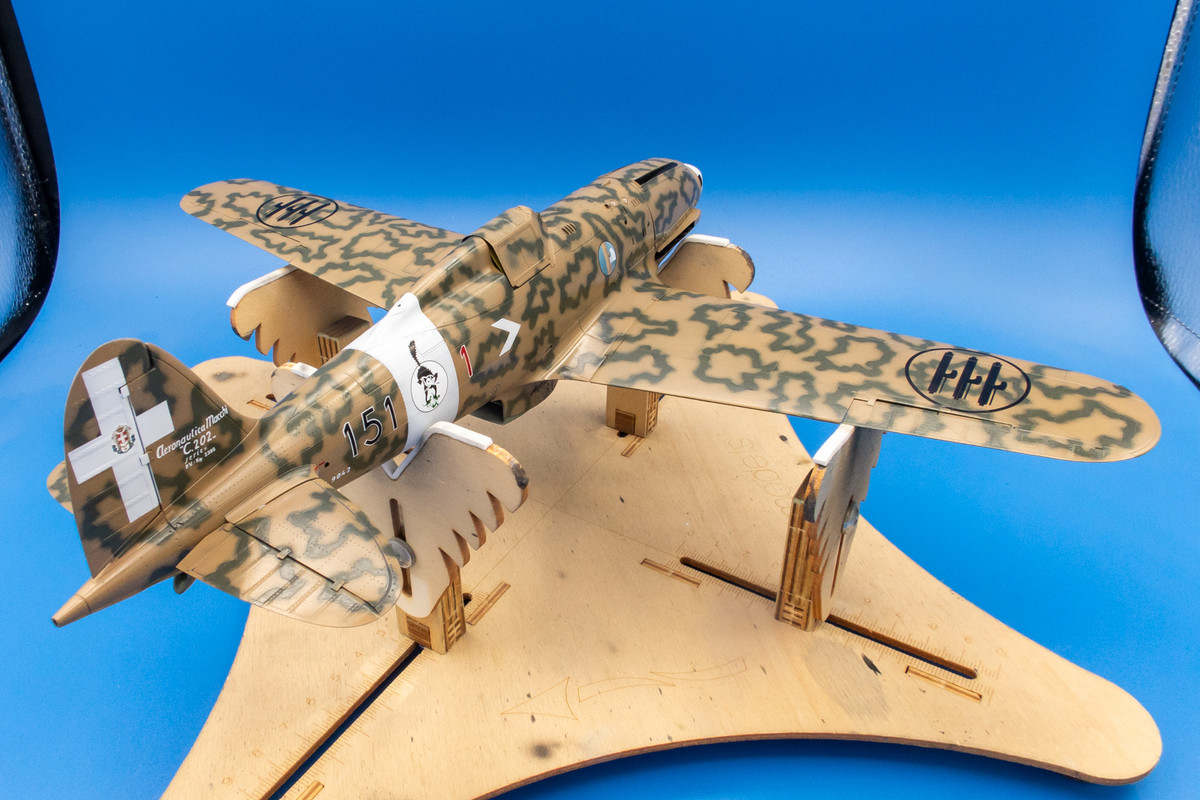

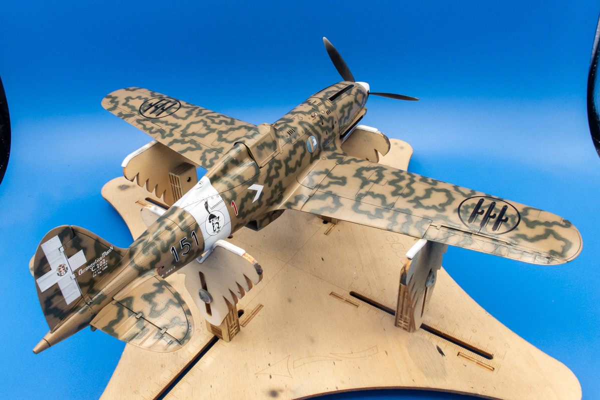

Thunnus Posted April 9, 2025 Author Posted April 9, 2025 The pastel wash has been applied over the fuselage so this stage is done. I've also glued the horizontal stabilizers in place. I'm tempted to spray on a flat coat now but I'm going to check over the painting and the wash carefully as the the next clear coat will lock everything in place. With the smoke ring camo pattern, it's easy to miss errant spots of pastel wash. Rocat, Shoggz, scvrobeson and 20 others 22 1
MikeMaben Posted April 9, 2025 Posted April 9, 2025 Is perfection possible ? When you mix pastel with water, do you eliminate surface tension with soap or something ? Thunnus 1
