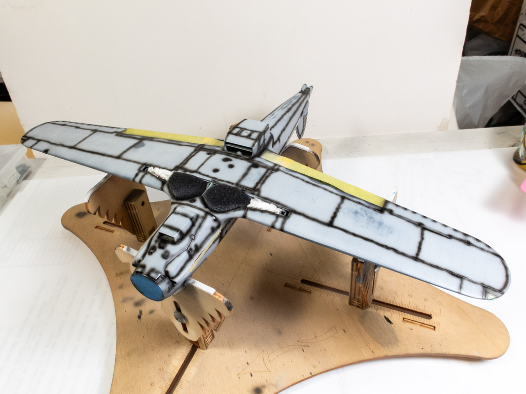

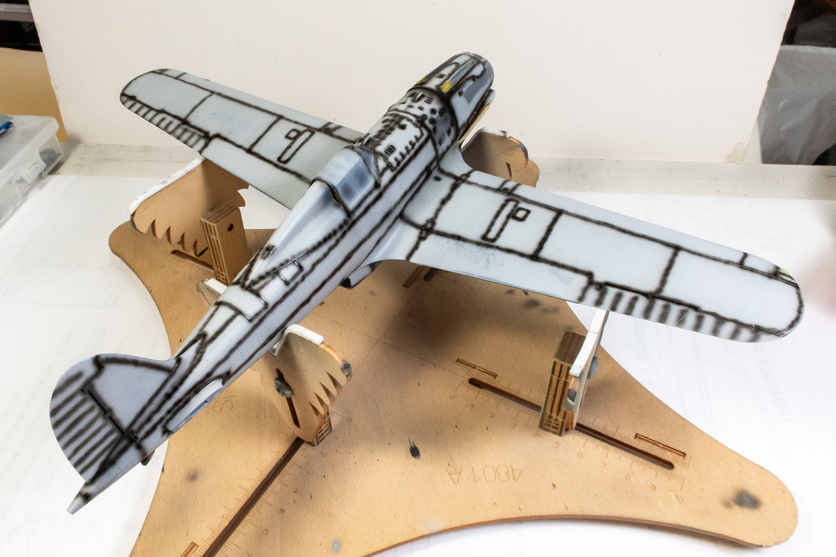

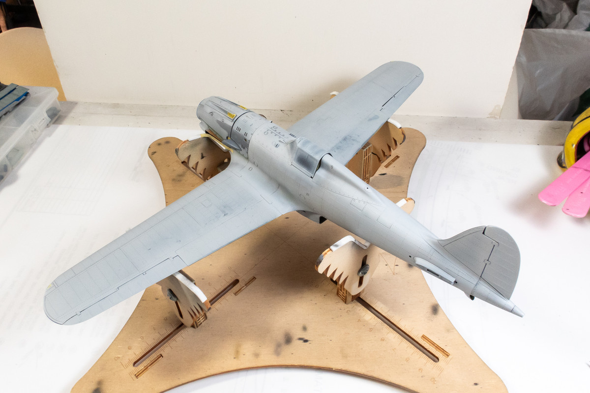

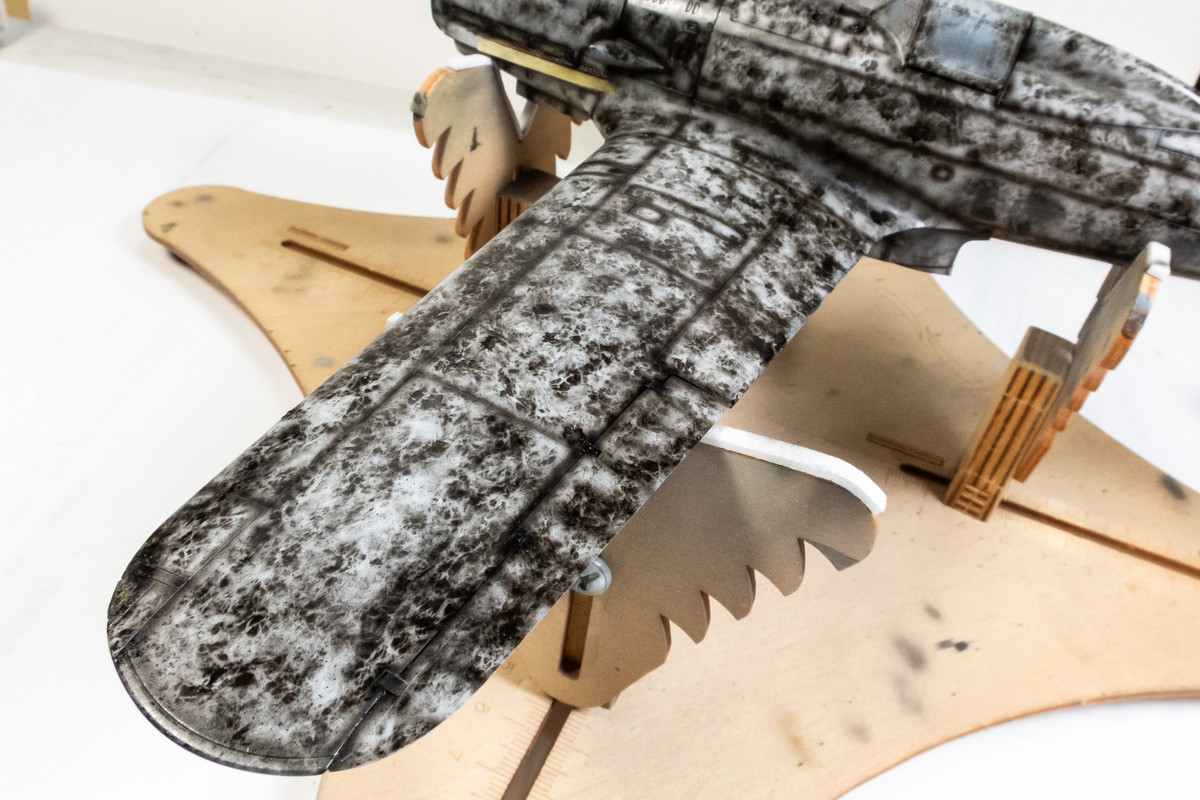

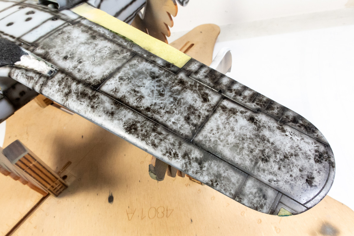

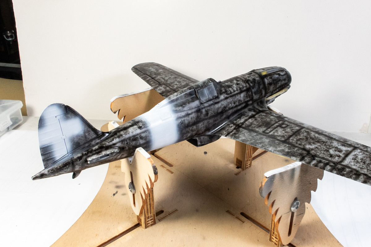

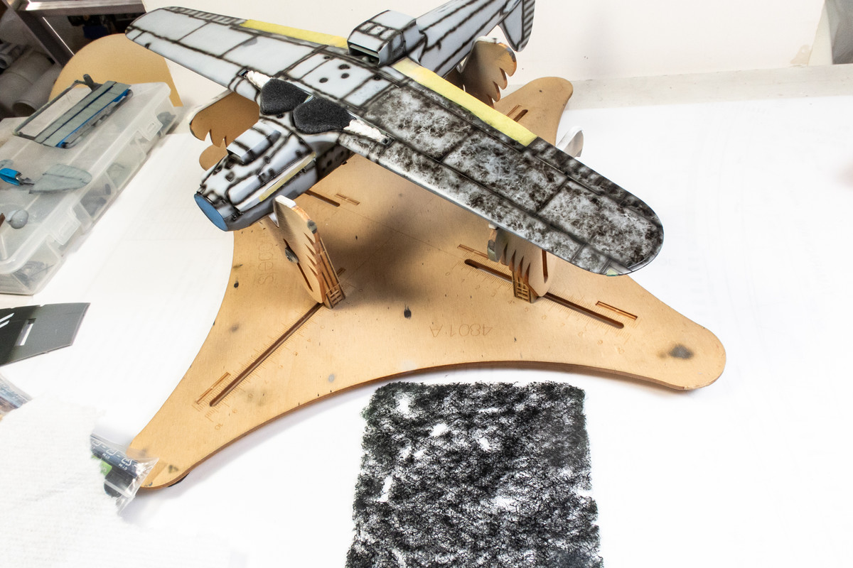

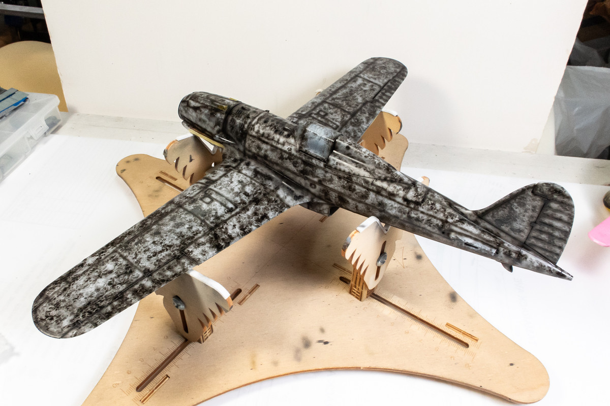

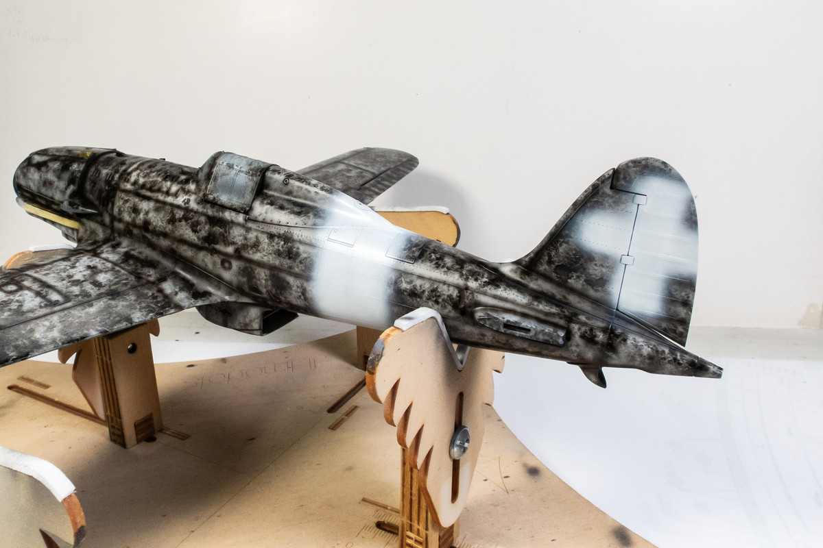

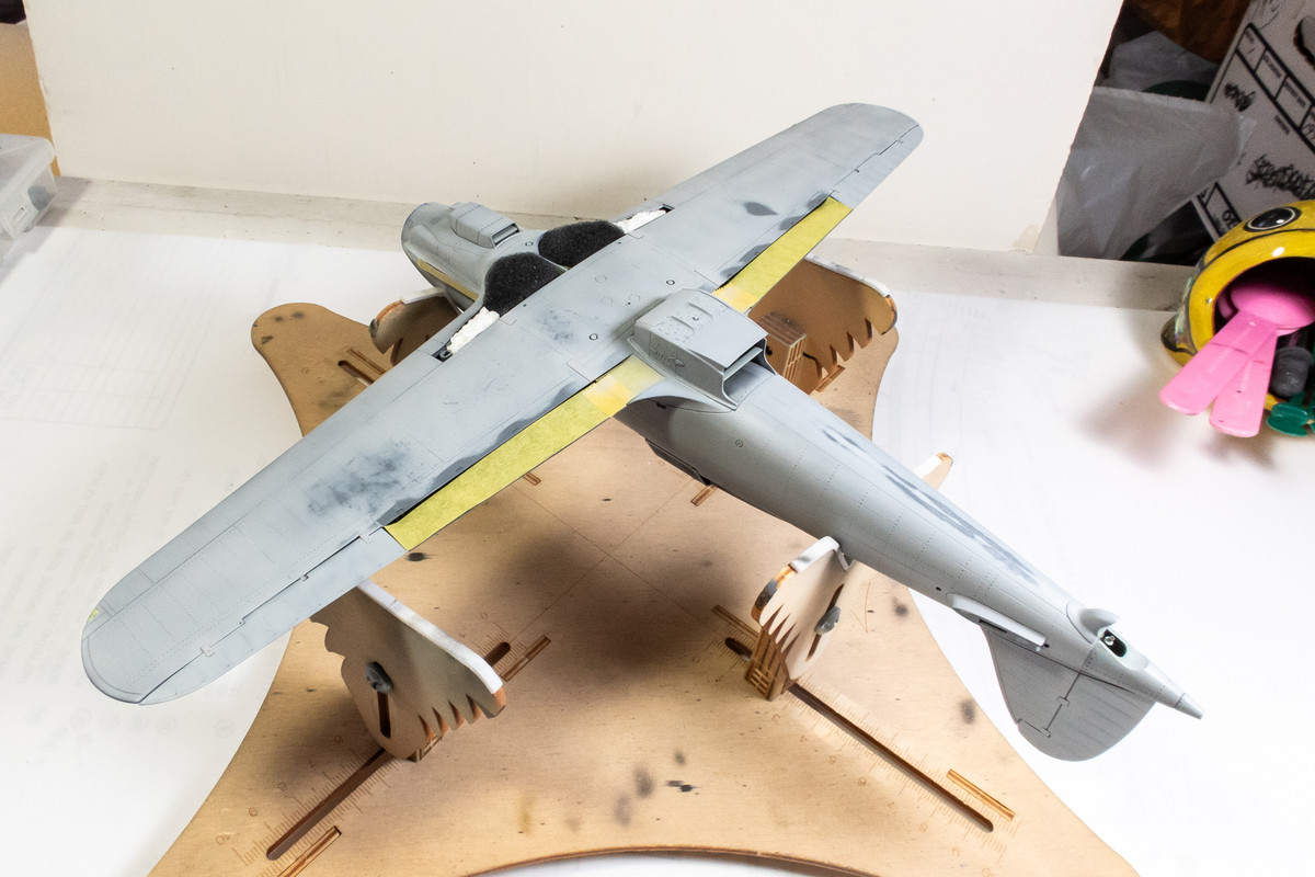

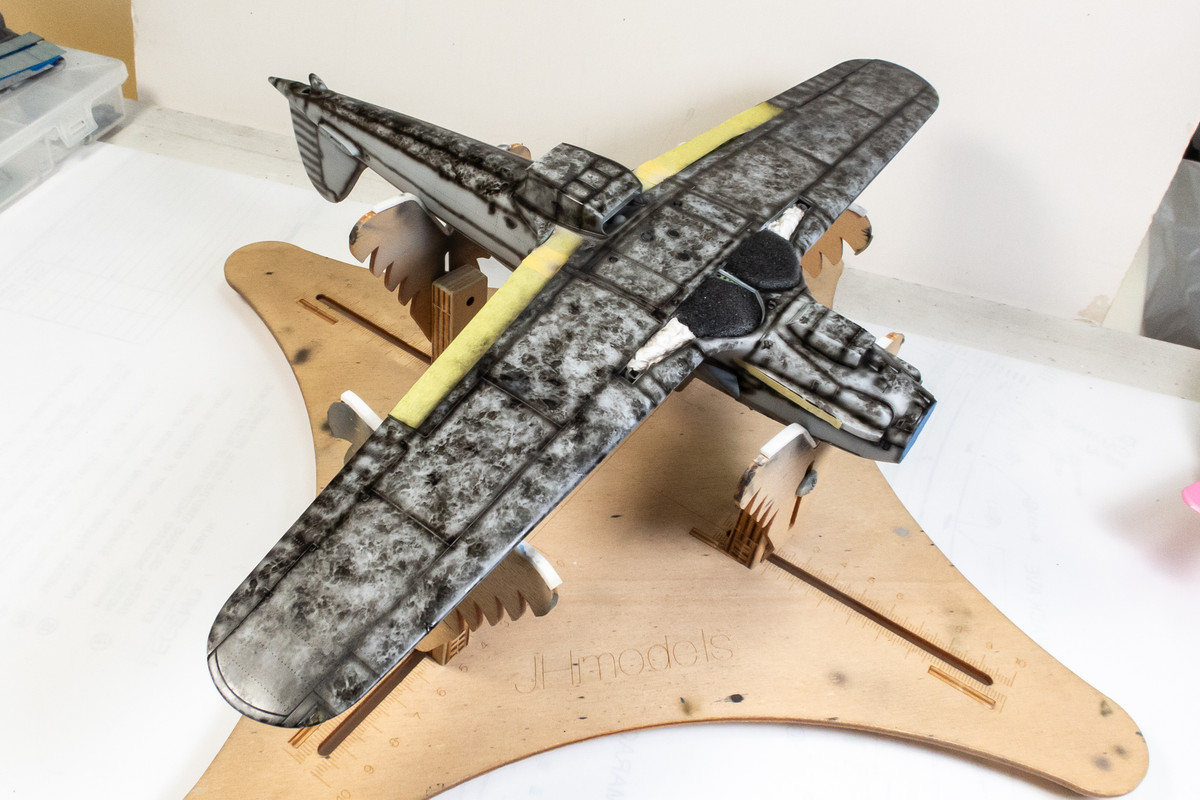

Thunnus Posted April 2, 2025 Author Posted April 2, 2025 11 hours ago, SwissFighters said: I'm gonna say...fair enough John! The paint will probably reduce the effect quite substantially in any case. I rarely ask such things, actually - in hindsight it was probably more a reflection of my incredulity that Italeri could make such a mistake. Keep up the great work! Thanks for sharing. Tony Thank you for your understanding. There is a list of Italeri head-scratchers on this kit. Of which some will not be addressed by this build. Before I start painting, the flap bays are masked using tape and the wheel wells plugged with a combination of foam and wet tissue paper. The painted AiP exhausts are covered with a thin strip of tape but I'm sure I'll have to do touch-ups there. The masked canopy is covering the cockpit opening and I've sealed the gap between the rear edge and curved fuselage fairing. I've even plugged the little holes in the engine cowlings with pieces of tape from the inside. Hopefully, I've covered all of the bases. The painting process begins with black paint over all of the panel lines. To create some modulation/tonal variation in the paint scheme, I typically put down a mottle pattern (also in black) using a piece of kitchen scouring pad. This technique is essentially the inverse of "black-basing". It looks gnarly like this but the effect can be dialed in per personal preference from very noticeable to zero by applying the camo paint in thin layers. I've decided to put down the white for the fuselage band and tail crosses now. After this dries, I will mask off the white areas and start on the grey undersides. TAG, Dpgsbody55, Shoggz and 16 others 19
Jaro Posted April 2, 2025 Posted April 2, 2025 Great! I wonder if brown marble won't be better for the upper surfaces. Maybe it'll blend better with sand colour, but that's only hypothesis. Have you tried? Thunnus 1
Thunnus Posted April 2, 2025 Author Posted April 2, 2025 47 minutes ago, Jaro said: Great! I wonder if brown marble won't be better for the upper surfaces. Maybe it'll blend better with sand colour, but that's only hypothesis. Have you tried? I have not tried but it is worth a shot if you want to give it a go. It does not tick the boxes for me in terms of what I am trying to accomplish with my preshading step, which may be different from other modelers. Black is chosen due to its high contrast with the underlying grey plastic/primer and I consider it color-neutral, meaning it will not tint or alter the overlying camo color other than making it darker. Keep in mind that black-basing is different and a shade of brown would probably be a good intermediate blending color when employing that technique. IainM and LSP_Ray 2
