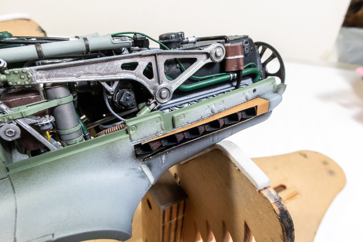

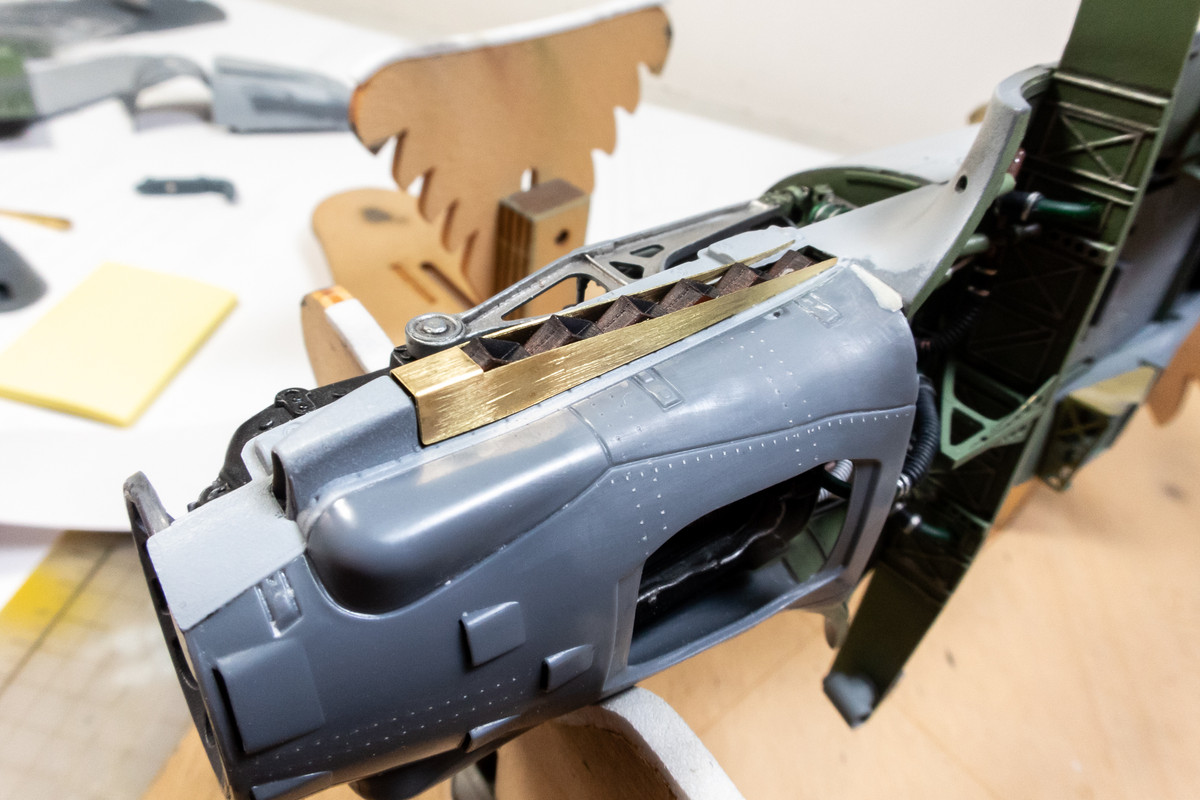

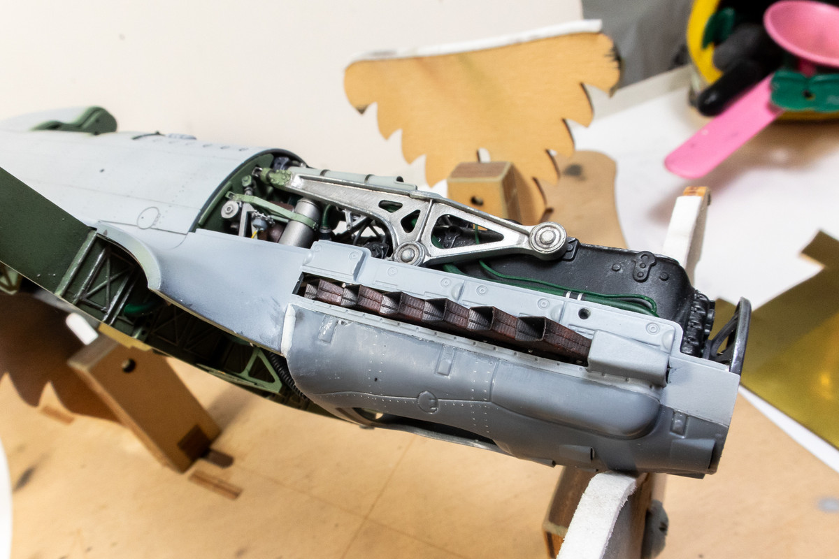

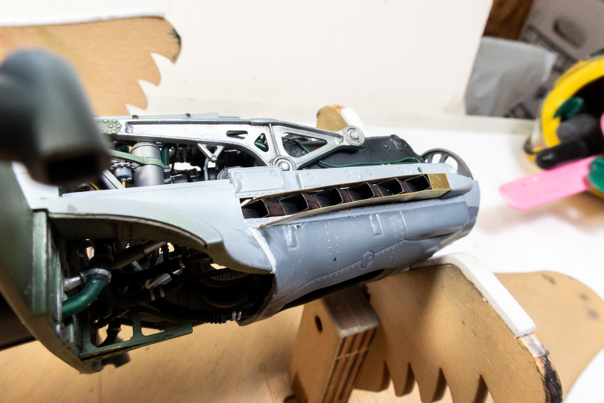

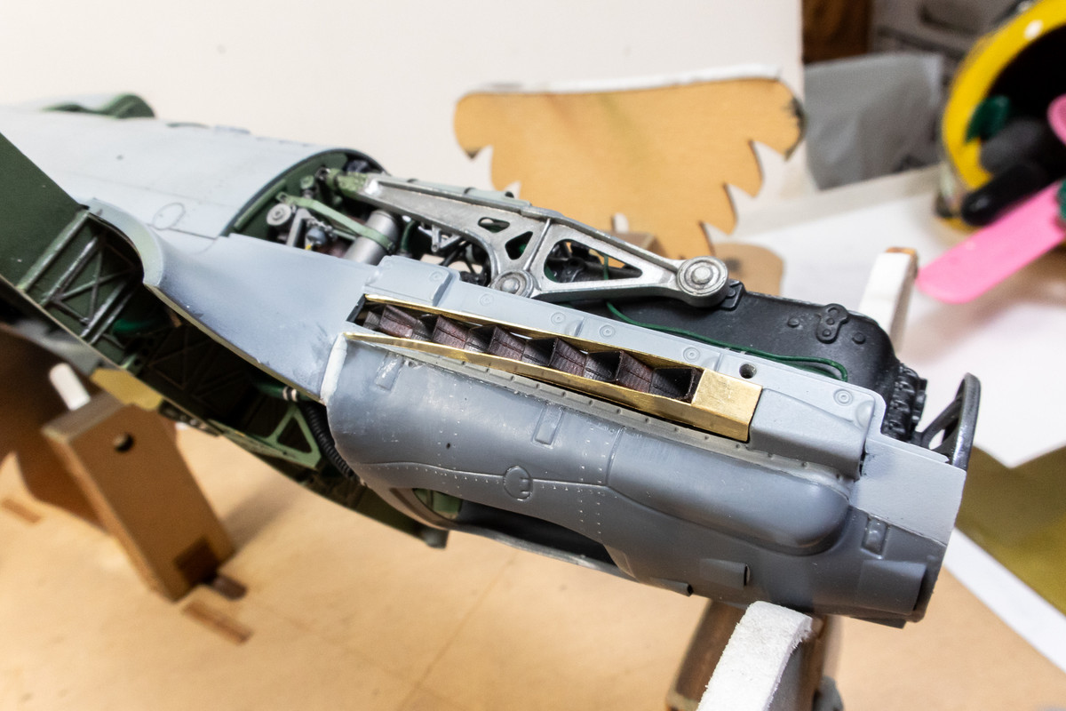

Thunnus Posted March 21, 2025 Author Posted March 21, 2025 16 hours ago, scvrobeson said: More awesome progress John! I am wondering if the exhaust stacks are far enough forward? Seems like the first pipe should be much closer to that front fairing, if not tucking under it like it does on other planes? That might solve the issues with the deflector plate. Matt Thanks Matt! Sorry if it is not clear but that front exhaust stack is tucked under the shroud and not visible from that perspective. Adjusting the position of one would throw off the spacing of the stack so I don't think I would go that route. I think I can adjust the shroud to make things fit. OR use the kit exhausts, which I am assuming do not conflict with the shroud. 13 hours ago, Rob Owens said: Yet another Museum Piece in need of a museum. . . Thank you Rob! 9 hours ago, Greif8 said: Continued top quality work John. It does seem that fit issues tend to "snowball" on some kits much more than others. Ernest Thanks Ernest! scvrobeson and Uncarina 2
scvrobeson Posted March 21, 2025 Posted March 21, 2025 4 hours ago, Thunnus said: Thanks Matt! Sorry if it is not clear but that front exhaust stack is tucked under the shroud and not visible from that perspective. Adjusting the position of one would throw off the spacing of the stack so I don't think I would go that route. I think I can adjust the shroud to make things fit. OR use the kit exhausts, which I am assuming do not conflict with the shroud. You were right, I wasn't seeing it with the PE part of the shroud added. I guess that the AiP exhausts are meant for if you have everything off, you might have to go with the kit ones if they're the best fit. Matt Thunnus 1
Dpgsbody55 Posted March 22, 2025 Posted March 22, 2025 Great to see more progress on this, and I'm also feeling a little bit vindicated in that the poor result of the exhausts on mine was not only down to my ineptitude and impatience. You are not alone in describing some of Italeri's build choices as being "strange". That would not be my word for it . I ran into the same issue with the brass exhaust shroud as you have done when fitted with the AiP exhausts. I was "locked in" at that point so I finished up filing out the centre part of the shroud. It took a bit of filing too and I would not go down this route again. That Quickboost prop and spinner looks great. I think a better choice than mine too. Incidentally, I fitted the gun cowl in three pieces and the removable panels needed a little widening with 0.5mm stock strip plastic. Even if you don't split it, it's still too narrow and is one of the few parts on this kit that doesn't fit well. Keep plugging away, John. I'm sure your model is going to look tremendous when done. Cheers, Michael

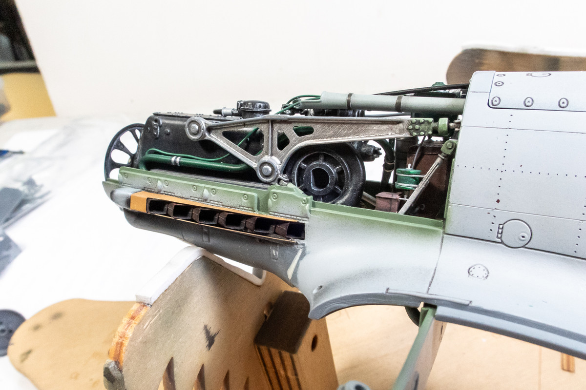

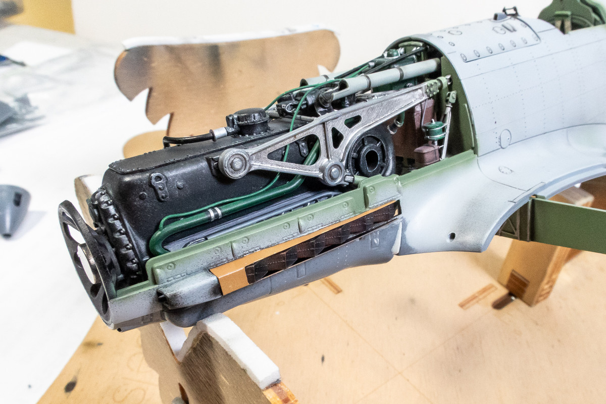

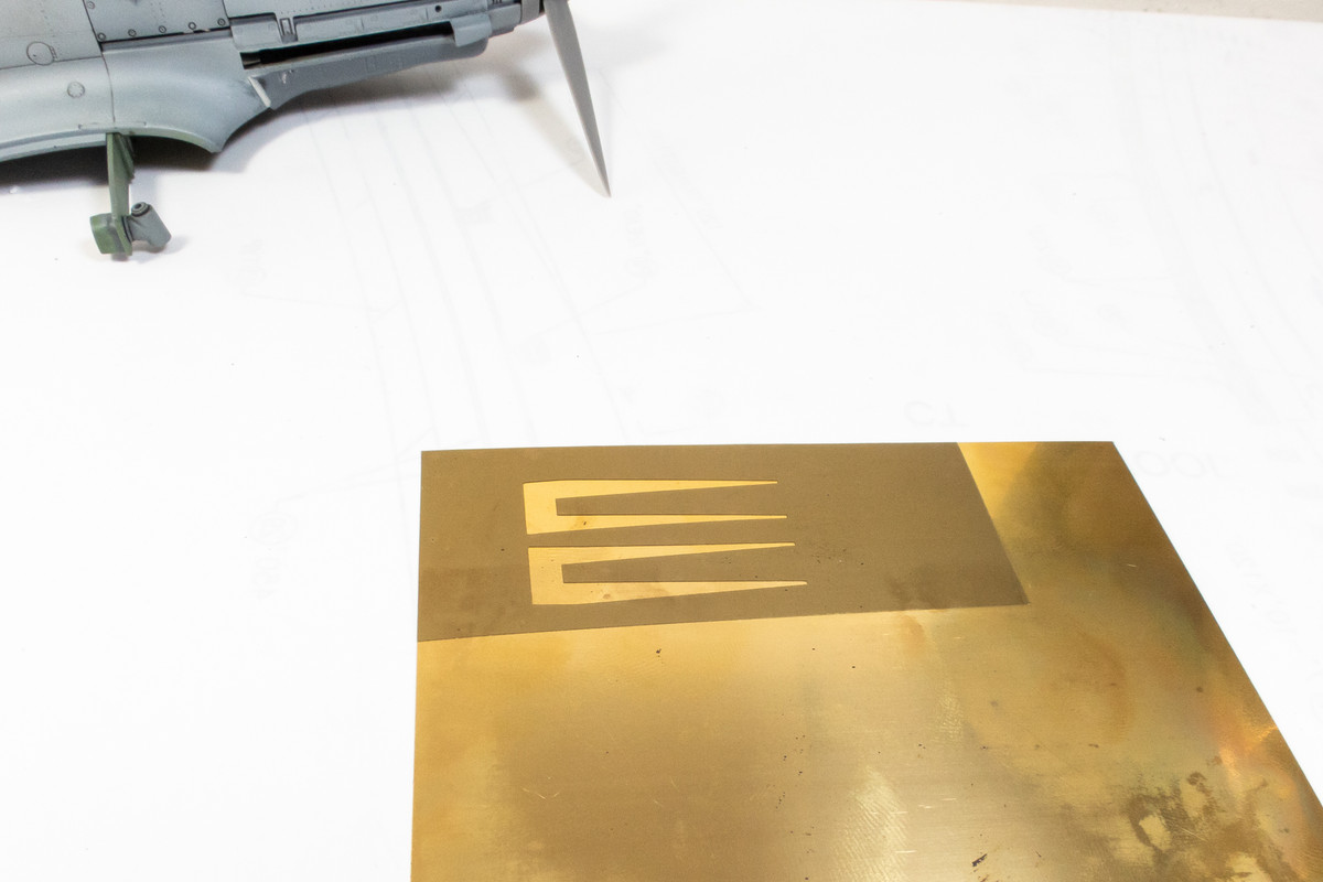

Thunnus Posted March 22, 2025 Author Posted March 22, 2025 Thank you Matt and Michael! The exhaust shrouds are very delicate and I didn't think I'd have much success trying to modify them so I decided to create new ones. The PE fret was previously scanned for such a possibility and I used the scan to trace a slightly modified set of shrouds in AutoCAD. I essentially made the cut-out for that front exhaust pipe deeper to accommodate that front exhaust pipe. The resultant masks were laid out on a sheet of brass and cut out using a sharp x-acto blade. The exhaust pipes were glued into place using PVA glue using an eraser tip to push them into place without damaging the paint. The new exhaust shrouds were then test-fitted. Once I was comfortable with these new pieces, I painted them to reduce the amount of masking I would have to do later. The painted shrouds were then glued into place using thin CA glue. I think that worked out ok. I'll spend some time cleaning up the joint between the brass shroud and the fairing in front of it but I can essentially move on. Madmax, dennismcc, AngryJazz_Models and 23 others 26
