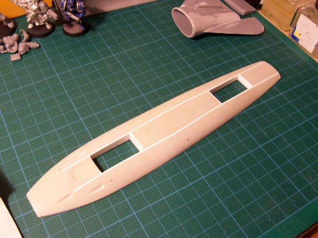

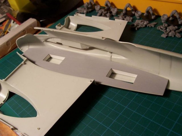

Hi gang,
A few pics of my lame excuse for a master pattern for the Revell Beaufighter kit. As the fuselage floor is the most critical (and strongest) part of the aircraft, this is where I shall start. You'll all get the general idea...the pattern is only partially complete, and is posted here to give you all some impression of how it will eventually appear in-situ. I have yet to make the actual escape hatch interiors, and detail the floor surface.
I had a look at the Duxford Beaufighter (DAP Mk.21) last Sunday, and took lots of pictures of the areas that I needed to know about. One thing I have established, is that the rear crew escape/entry hatch is in the wrong position on both the Revell kit, and the SAM Datafile drawings! It is too far forward, in fact, it is pretty well represented as being directly underneath the observers/gunners seat. This cannot be so, otherwise, it could not open. The front of the aft escape hatch is nearly central to the seat, but the aft edge of the hatch is quite a bit further back (I would guess approximately another 6.0 mm or so aft, I shall have to verify this). So be warned, check the photographs carefully, and don't rely on the kit panel lines or scale drawings (unfortunately, I fell into this trap, and at the time only having the kit and no accurate reference material, decided to use the kit hatch position as my datum for the rear hatch - it is incorrect, so I shall now have to rework the pattern, as it is wrong in this respect ;) ). The forward pilot's escape/entry hatch appears to be in about the right place, so I have gone with the kit dimensions on this one.
Cheers
Derek

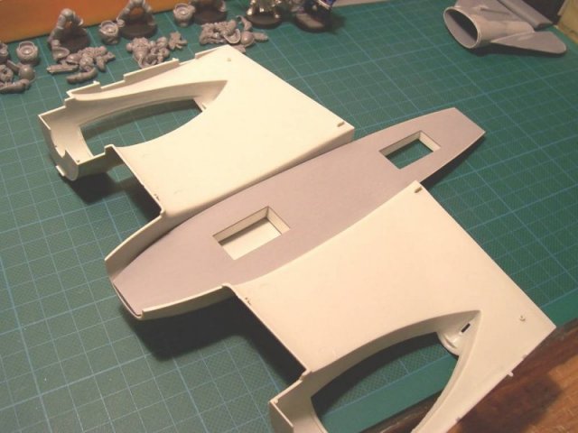

Posted 01 December 2005 - 10:24 AM
Previous picture shows the underside of the fuselage floor insert, with both fore and aft escape hatches (the aft one shll have to be reworked and positioned further aft by approximately 6.0 mm). This picture shows the same view of the floor insert, and the area of the kit where it will be placed.

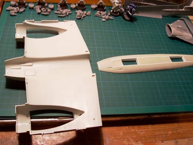

Posted 01 December 2005 - 10:25 AM
The top side of the floor insert.

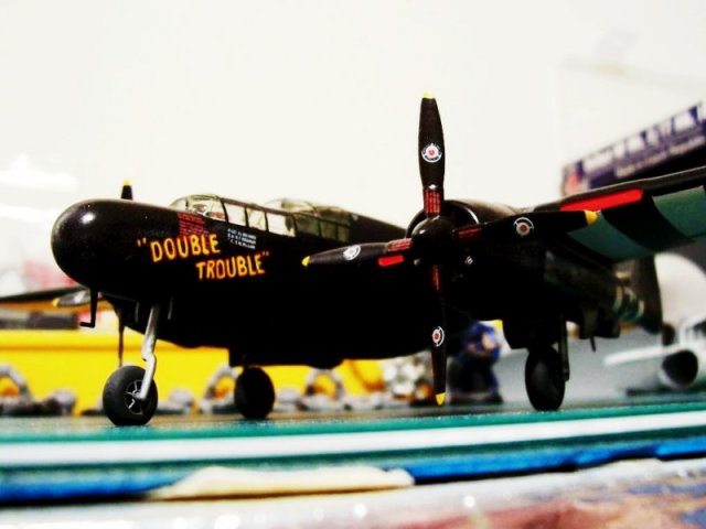

Posted 01 December 2005 - 10:34 AM
View of floor insert in place within the kit centre section.

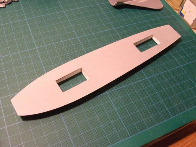

Posted 01 December 2005 - 10:39 AM
Another view of the floor insert, this time, with the right (starborad) fuselage half in place. This is the extent of the floor on the full size Beaufighter.

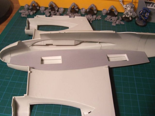

Posted 01 December 2005 - 10:42 AM
Another view.

Eventually, I hope to cover all of the major marks of Beaufighter (If, IIf, Ic, TF.X and DAP Mk.21), with maybe bits and bobs for other marks also. Once I have the floor corrected (I have just received some accurate measurements for the aft escape hatch from Duxford), then I can start on the left and right interior fuselage inserts, or shells. The shells will be detailed with a generic internal airframe structure and common equipment. Specific equipment will be supplied for various Beaufighter marks as required.
