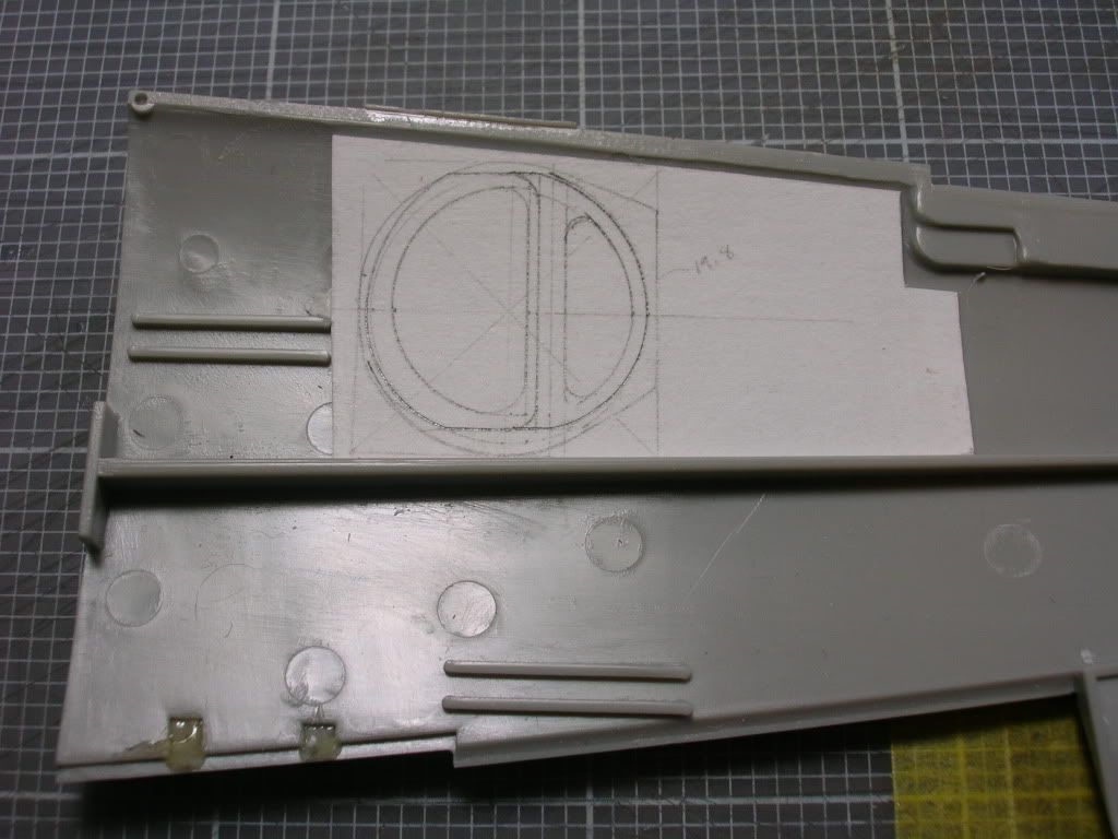

dodgem37 Posted May 22, 2010 Author Share Posted May 22, 2010 Thank you, gentlemen. I haven't been able to put a lot of time on this this week because of work, but I do have a little something to show. I wasn't planning on putting in more time into the wheel wells but I threw caution to the wind with the hope that I wouldn't mess this effort up and starting scratching the parts. I hesitated to document and post the process because I don't know if anyone would be interested and I wondered 'Who am I to show others how I do something when so many of you have so much more skill than I', and besides, one can buy the stuff from Radu. Firstly, forgive me for stepping on your toes, Radu. But, I decided to chance it. I know the images are large, and I apologize. I don't know how to make them smaller. So here goes: I cut out a piece of index card and tacked it down with Uhu (brand name) white 'blue tac' and traced the opening onto the card. Here I've already sketched a general layout. 19.8 is the mm diameter of the outer circle. The base and side must abutt. This is a constant. Interestingly enough the base the card sets against is the wing spar. Which is good. Here it is with the wing bottom attached. I shimmed the front because of a gap. I used adhesive backed paper packaging tape to use as a stencil. It's sturdy, won't stretch, and can be used again, for the other well. So only one stencil needs to be made. You just work on the other side of the part to make the opposite hand. I've already trimmed it. The excess that wraps the corner will go underneath the small strip and intersect with framing. Since I would be removing the side panel I went ahead and stenciled it as well. The stencil was removed, located on .005 plastic sheet, trimmed with 1/2 mm excess on top and bottom, and the ridges sanded off. A little adhesive residue needs to be clean up. The side panel was removed. The curved line of the well walls were retained in the removal of the small strip and a small shelf carved into the corners. Strips of double-sided adhesive flim were located to use as an adhesive for mock up. The part in place. Linework. Three more pix to come. Thanks for looking. Sincerely, Mark rafju, Pastor John and Greg W 3 Link to comment Share on other sites More sharing options...

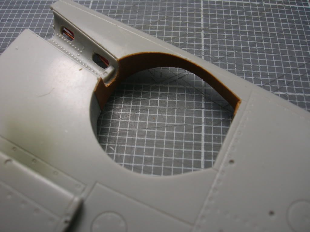

dodgem37 Posted May 23, 2010 Author Share Posted May 23, 2010 Thank you Dave. Thank you, Paul. I'm dutifully plugging away with the remaining 3 walls. I've been making their outlines with index card. I have some fine tuning to do and luckily they are falling into place. It's all of that extra detail I am now noticing that I am now asking what have I gotten myself into. The photos I have don't have the leather half cover like the Hartmann G-14, so all of the conduit, wiring, and lightening holes are exposed. Oh me! I received a PM from a gentleman by the name of (Mr.) Ali, who, it appears cannot post as of yet, noticed that I had installed the control column here (and to the G-14 on the other thread) backward. You are as right as rain! Thank you for your eagle eye. Luckily they snapped off at the point of connection and after a little sanding and scraping they were able to drop into place without too noticeable a reveal. Thanks for looking. Sincerely, Mark Link to comment Share on other sites More sharing options...

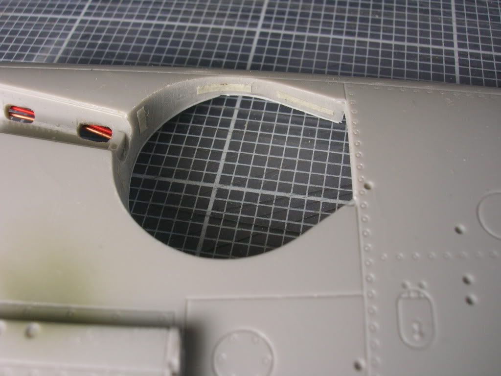

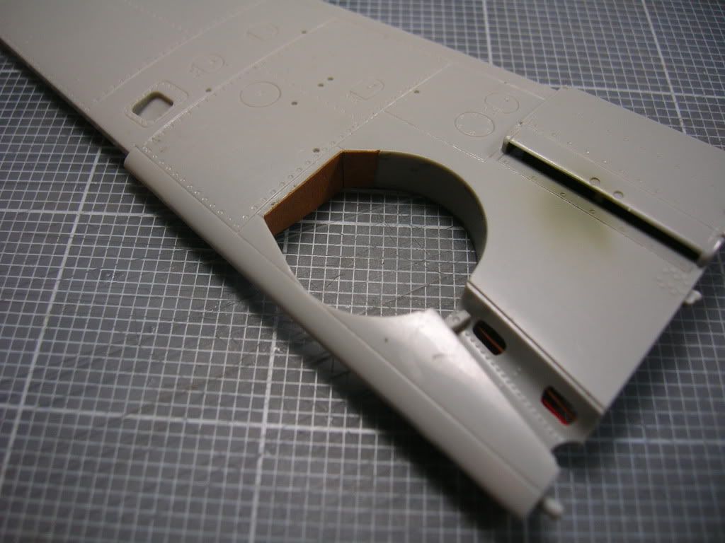

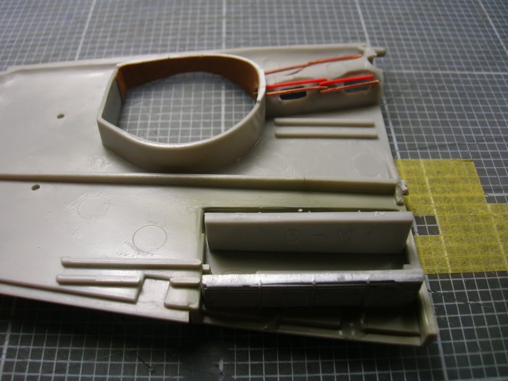

dodgem37 Posted May 26, 2010 Author Share Posted May 26, 2010 I've been plugging away on the wheel wells and did some bits on this and the G-14 in the Tribute to Russ Group Build to take a break from the wells. Exhaust shields cut from and aluminum pan top. I made the spent cartridge chutes anyway. Out of the same aluminum. Outside wall. I'm building out the wall edges. Inside wall. As luck would have it, I did OK the first go around. This was the easiest wall. How could it not be? It's just trimmed squared strip. I cut some index card strip and taped each to the spar on the wing's top and bottom then glued them together. This solved the problem quickly. I found it's easy and fast to check the fit if the wing is clam-shelled. That's all for now. Thanks for looking. Sincerely, Mark rafju, Pastor John and Greg W 3 Link to comment Share on other sites More sharing options...
