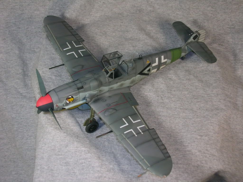

Gentlemen,
I just finished this kit, and thought I'd put it up for show.
It may suppose to go into the Aces Build, I don't know, but I'll let the Mods make that decision.
Posted Image
The scheme is standard RLM 74/75/76 over a base coat of Primer. Preshading was with FS36081 Euro Grey I. RLM's were tinted 20% white. 5 parts RLM/1 part white. Defence band was mix of RLM 4 & 24 (I think blue is 24), with 20% white. Camo was scanned, enlarged, and paper stenciled from Cutting Edge CED32026 Gustav Aces Part 2. I used blue tack to set the stencils off, but a tight line was the result anyway. The Solvaset system was used for the decals. Weathering on the top was done with lamp black. I replaced the broken tail wheel shaft with brass rod and set the wheel at an angle. Swastika is painted.

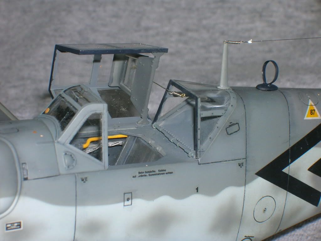

Cockpit sidewall wiring, interior windshield handholds and flare tube, rear cockpit detail including retaining wire and spring connecting the center section with the rear, and some other stuff, which I don't know what it is. I tried my hand at making the antenna wire, antenna wire spring, and rear connecter. Wire is invisible thread painted steel. Insulators are white paint. The DF loop is flattened solder. I don't know what those spots are. Desicating tablet is RLM79. Masked cockpit glazing interior and sprayed it RLM66. Painted glazing edges black to represent rubber seals. Delicate slip streamed weathering around panel lines.
