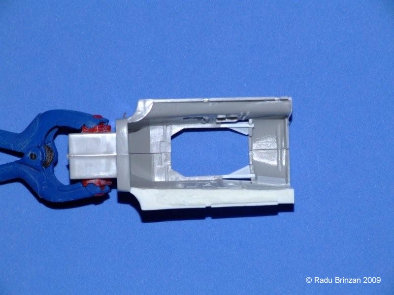

When I started the work, I soon discovered that the cockpit section was too large. I am well aware that resin can play tricks sometimes and it can expand or shrink.
In this case, the expansion was significant enough to cause a bit of a problem. The part was too long and too high. This photo shows the extra length.

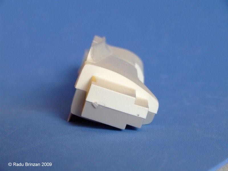

And this is a view from the back.

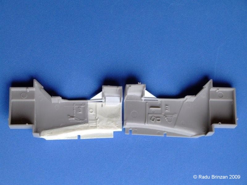

Sanding the parts would actually cause more problems, so I had to find a fix. With a bit of surgery, I cut the kit part and the conversion part.

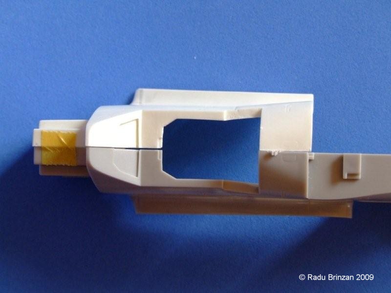

And this is the fixed part.
This way, I have a rear part that fits the fuselage and a front part that fits the resin nose. More photos soon. Radu

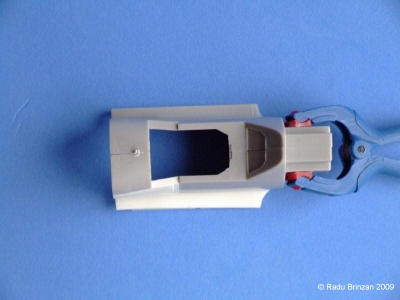

I did a little more work on it. One of the main problems with the cockpit is that the sills are bent and stepped to account for the deeper quarterlights of the windscreen part. On the real thing, the sills were straight and the bottom edges of the windscreen quartelights were just metal sheet overlapping the sides. Also, these were applied on top of "regular" quartelights. Here is a photo that shows the bent sills and the step.
