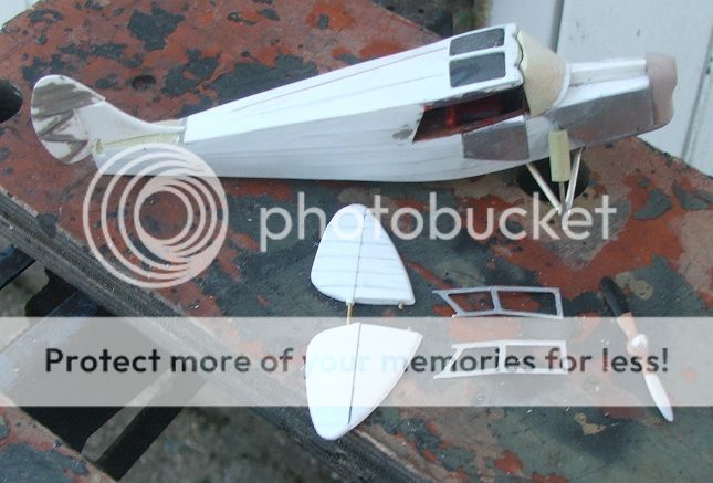

Posted 21 July 2017 - 08:17 PM
As promised, photos up to date.  Alas, I have been gardening and researching an English Electric Lightning as my dear wife has ordered me an Airfix 1/48th scale kit, out of the blue.
Anyway, here we have an as yet incomplete Milliput pattern for the windscreen (an absolute bar steward to hold in any direction!)
Tailplane and elevators with rib-impressed 10 thou. skins. Elevators slightly down. I like that look.
Wings started. Roughly shaped with chisels to save on dust production.  One 10 thou skin waiting for rib impression.
Prop. sanding sealered and painted a la real kite at Felthorpe.
More anon.
Martin

Went to buy a mini freezer from a local guy and he offered me this workmate, cheap, which has its legs welded down which means I can move it round outside the shed.  I use it to put the bandsaw or belt sander on so the dust blows away. It lives outdoors.  So useful.  I can only get decent pictures in outside light.  I suppose I should keep a neutral sheet of something for photos, but I ain't a photographer!
